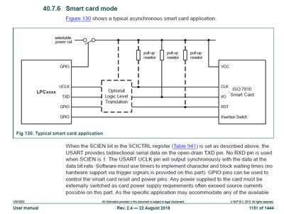

Hello, I am trying to setup a smart card interface to communicate my mcu with a MIFARE SAM AV2 chip using the USART Smart Card Interface that is described in the user manual (12.6.2).
I am attaching the connection diagram to the post, as well as a couple captures from the user manual.
Something that's puzzling me is that the UM specifies that the TXD pin of the USART should be open drain, but upon further study the only 2 pins that are open drain in this part are being used by the i2c0 peripheral. Moreover, unlike other LPC parts, this one doesn't have a "open drain" mode for the digital pins, so that's not an option either.
My question is how exactly does one go about configuring this interface on this part? I looked for examples but found none in the support packages. I couldn't find any NXP application notes on the subject either. Is it actually supported? I know the registry to enable to mode exists, but I don't know if it is actually supported by the hardware on this particular line.

Ok I've looking into the examples and I've gotten to the point where I get a clock out through the UCLK pin (3.7MHz) which matches my desired 9600 bauds at a 372 oversampling rate.
However, despite seeing the target device sending data through I/O line at the desired baud rate utilising a protocol analyzer, I cannot pick up this data with the USART (the interrupt never triggers).
I attempted to send data as well but I can't manage to get anything out either. I am following the example that was linked. It doesn't look like you have to do anything too fancy to get it to work, but I don't seem to get anything out. If I disable the smartcard mode it starts transmitting straight away at 9600 bauds (leaving all the other config as is) but of course this is not what I want.
I am quite confused as to what would be causing this, but I haven't really found anyone who's talked about getting this particular part to work with this interface to really have a 1 to 1 comparison or anything to go on with.

Hi, Martin,
For LPC43xx, only USART0, USART2, USART3 modules support ISO7816 protocol, for detailed information about the pin connection, pls refer to section 40.7.6 Smart card mode in UM10503.pdf, I copy the part here:
In ISO7816 mode, the TX pin is an open drain and bidirectional pin.

Yeah, I saw that part already and I attached it to the original post. In fact a large part of my post is based around asking questions about that very part of the user manual you are quoting as being the solution.
I don't think the TXD pin is actually bidirectional as it's not referenced as such in the pinout, only in that one section. The i2c pins, on the contrary, are shown as being open drain in multiple places, what makes me think this might not be the case on the USART. If you have actually used it and can verify it actually works the way you mention then that would help.
