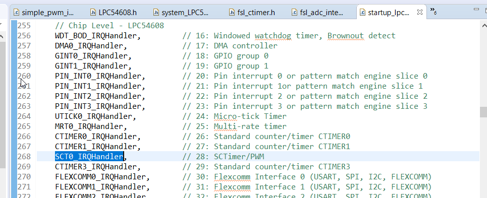

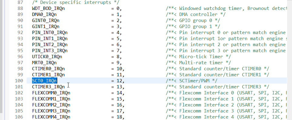

soledad
Could you please double check in the LPC54608.h the IRQ name, in code you have
"EnableIRQ(SCTIMER_0_IRQN);"
I found the following definition
In addition please check the ISR vector.
I hope this helps,
Have a nice day!
Soledad
