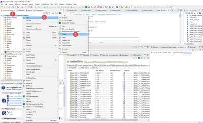

xiangjun_rong
You can add the group like the fig.
The red means right-mouse clicking.
Hope it can help you
XiangJun Rong

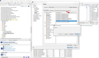

xiangjun_rong
Can you clarify your question?
do you want to create a directory which includes multiple *.c and *.h. If it is the case, it is okay, you can add the path in the project as the following fig.
Xiangjun Rong
