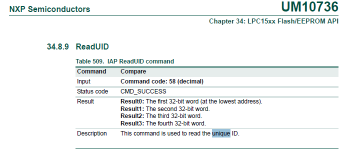

I need to know how to read the LPC15xx/LPC176x unique serial number in application. I know it is possible to read it by means FLASH MAGIC, for exemple, but I need to read it running the application.

Hi Carsten! Unfortunately it didn´t work ... I did the following code:
// LPC1518 IAP accesses
#define IAP_Read_UID_Command 58
#define IAP_LOCATION 0x03000200
unsigned int IAP_command[5];
unsigned int IAP_result[5];
typedef void (*IAP)(unsigned int [],unsigned int[]);
IAP iap_entry;
IAP_command[0]=58;
iser0=NVIC->ISER[0];   // temp copy
iser1=NVIC->ISER[1];   // temp copy
NVIC->ICER[0]=0xFFFFFFFF;   // block IRQs
NVIC->ICER[1]=0xFFFFFFFF;   // block IRQs
iap_entry(IAP_command, IAP_result);   // read UID
NVIC->ISER[0]=iser0;   // restore
NVIC->ISER[1]=iser1;   // restore
The point is: my program stoped at iap_entry(IAP_command, IAP_result) command and didn´t run ... it didn´t "came back" to main program ...
Any tip? I´m doing something wrong ... but don´t know what ...
Thanx in advance!

The IAP entrypoint is:
/* Pointer to ROM IAP entry functions */
#define IAP_ENTRY_LOCATION 0x03000205UL
I use the function from LPCOpen (using Keil) for my test and they seem to work.

Carsten, before I download the LPCOpen support, I´ve tried the following:
#define IAPCommand_UID_Read 58
iap_entry=(IAP) (IAP_LOCATION+5);   // ???????????????
IAP_command[0]=IAPCommand_UID_Read; //
And it worked-out !!! I read the iap_entry=(IAP) (IAP_LOCATION+5) structure in some Application Note ... But the point is: I can´t explain why the code works with it ... and crashes withou it ...
