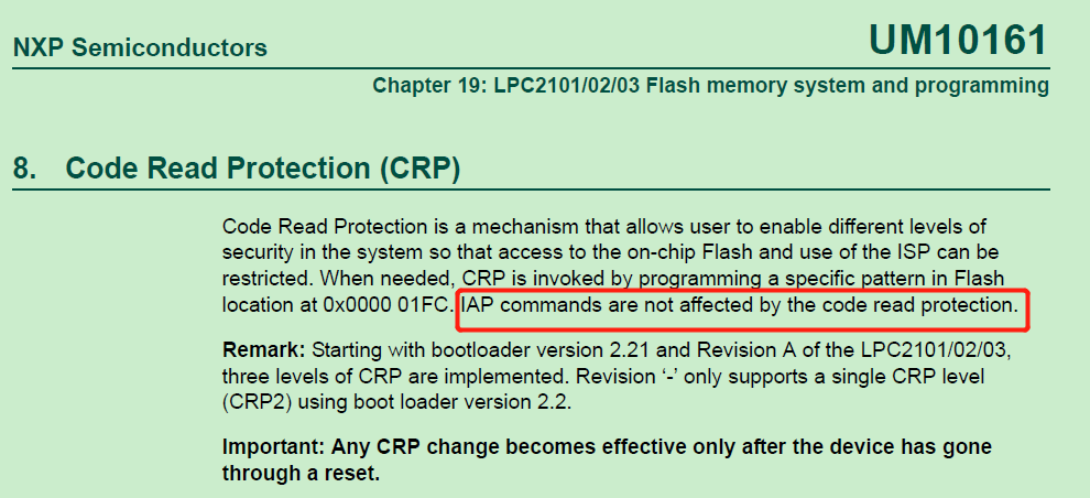

CarlosCasillas
Hi Mark,
Below you can find internal reply:
A recommendation is enabling CRP and protect MCU from ISP mode, as explained on page 246 of User Manual UM10161:
https://www.nxp.com/docs/en/user-guide/UM10161.pdf
CRP3 can disable ISP function after hardware reset. special noticed here, customer better open a backdoor in application code the reason is:
Once enabled CRP3, the JTAG and ISP functions are all disabled. User can not debug or update firmware through JTAG or ISP.
Believe the ISP firmware won't erase other sectors. So, other recomendation is checking the IAP or firware update function.
Make sure hte IAP is running on SRAM area and disabled interrupt before operate flash by IAP
Hope this will be useful for you.
Best regards!
/Carlos

CarlosCasillas
Hi Mark,
An additional reply from AE team include the following:
It can used the CRP command to disable ISP and JTAG functions to flash.
And using IAP command to write to and erase the final sector of the Flash to store parameters. Because IAP commands are not affected by the code read protection. Take a look to UM page 246:
So, the option could be trying the CRP on one bad devices.
Best regards!
/Carlos

mjbcswitzerland
Specialist V
Hi Carlos
Many thanks for the update.
This means that the rules for "internal" and "external" ISP commands are different.
I will verify first that the application works normally in CRP2.
Since I am worried that the problem is sporadic 'internal' ISP it may not help protecting the operation but in case it proves to be external ISP (eg. a disturbance causes the board to reset, enter ISP mode and interpret a command) it may do so.... !
The down side is that it will no longer be possible to analyse what part of memory was lost since the read will not be allowed, but if it results in an improvement this wouldn't be necessary anyway.
