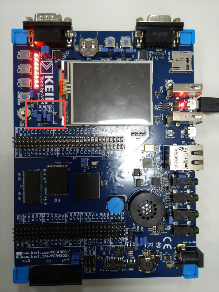

I just receive a new evaluation board for a colleague (also MCB4300).
Before do anything  with this board I put Jumper as on your board and I connect it to my PC with USB cable.

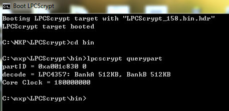

Then I launch boot_lpcscrypt.cmd and I got same result :
  • Booting LPCScrypt target with "LPCScrypt_158.bin.hdr"
    LPCScrypt target boot failed:
    Cannot open device

The version of my LPCScrypt is v1.8.2, please referring to Bernhard's reply which illustrates the procedure of entering USB ISP mode.

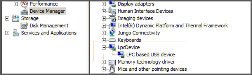

bernhardfink
The USB boot mode is based on the DFU usb profile (device firmware upgrade).
This means that you see a DFU device in the Windows device manager:
My hint of the day:  when you have the board connected as shown above, make another reset, but keep the ISP button pressed while pressing the reset button.
Background for this procedure is, that if there is a valid program in the internal flash, then it starts from there and doesn't go into USB boot mode (nor in any other boot mode). It simply starts from the internal flash. With the ISP button pressed during reset this procedure is overruled and it goes into the bootmode determined by the jumpers.
Bernhard.

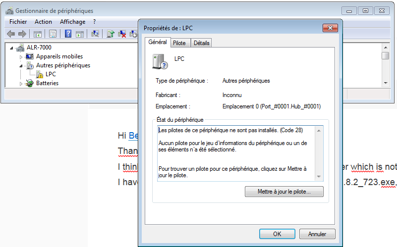

julienbrissard
Hi Bernhard Fink,
Thank you for your reply.
I think that my problem come from the DFU_winusb_driver which is not installed.
I have installed dfusec_v1_11 and LPCScrypt_installer_1.8.2_723.exe, but If I look in Windows Device Manager I see that driver is unknown.
But if I want to install the driver from this window (update driver), and then select  AN4370SW\DFU_winusb_driver directory, Windows does not find it (even if there is DFU_Device.inf and DFU_Device_runtime.inf Inside).
If I right_click on DFU_Device_runtime.inf and select install, I got an error also.

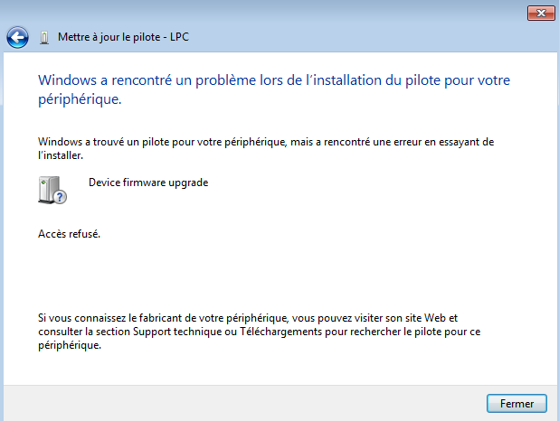

If I try to follow chapter "5.4.1 Driver installation" of AN4370_USB DFU boot loader for MCUs.pdf, then after selecting DFU_Device_runtime.inf, I got an access error :
Do you have any hint about my problem ?

jeremyzhou
Thanks for your reply.
You can run the script whose name is InstallDrivers is provided in the scripts directory and this script must be run as an Administrator to enable the drivers to be installed.
Hope it helps.
