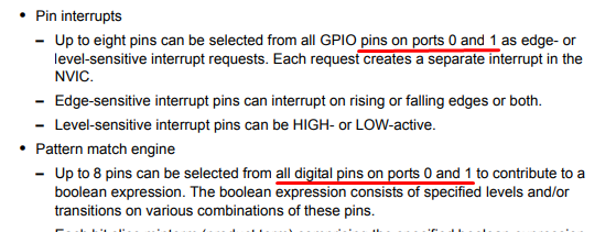

Hello Kimble,
Sorry for the misunderstood. Using pin 7 on port 4 as an interrupt is not possible. Please refer the user manual (UM10912.pdf) chapter 12, you will find the following information:
All the eight pins that can be selected as a pin interrupt mus be from port 0 or 1. That's the reason why in the examples we provide with the SDK we only use pins of those two ports.

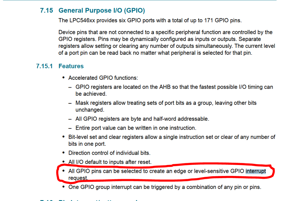

florentfortin
Please update the LPC546xx datasheet too...
This description let us know we can get interruption from all ports, instead of only port0 and port 1!

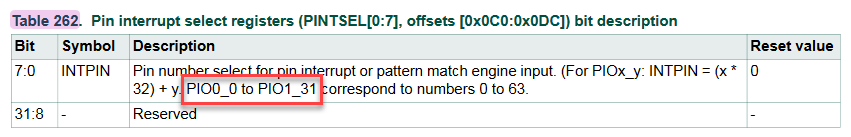

I'm using an LPC54606 and I had the same problem.
I would like to use a Pint on PIO4_25 and I thought that it was possible bescause it's not totaly clear in User Manual.
Indeed when we look at the "Pin interrupt select registers" (table 262 pages 202 and 203), in the description it's not wrote that it is exclusively reserved for PIO0_0 to PIO1_31, espacially as 6 bits would have been enough to count from 0 to 63. And even more when it is writen in the datasheet  (on page 67) that: "all GPIO pins can be selected to create an edge or level-sensitive GPIO interrupt request".

victorjimenez
Hello Karim,
The user manual was recently updated, please download the newest version.
Regarding table 262 from the user manual please noticed that in the description it's written that it is exclusively reserved for PIO0_0 to PIO1_31.
I already reported the issue regarding the following statement on the datasheet.
all GPIO pins can be selected to create an edge or level-sensitive GPIO interrupt request.

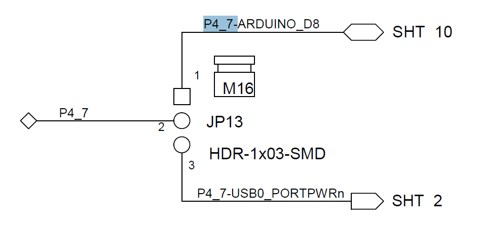

Hello Kimble,
Please keep in mind that PIO4_7 is mapped to JP13 and depending how JP13 is connected is the functionality of the pin. See image below.
For your case you need to connect JP13 to 1 and 2, this way you can configure this pin as a GPIO interrupt, otherwise, the interrupt will never be triggered. Did you keep this in mind while making your project?

Hi Victor,
I had checked that already, in fact it was jumpered that  way (1->2) from the factory.
Do you know the 4-5 steps that i would do to enable with pin as an interrupt ? Like i mention in the original post, following the examples from NXP i can only get pins on ports 0 and 1 to work (which is how the examples seem to be set up). I cannot get any pin that is not on those ports to work.
I think it is a coding issue, but I don't know where and i have been going through as much documentation and trying everything i can to get it to work, still no luck :smileysad:

victorjimenez
Hello Kimble,
Hope it helps!
Victor.
