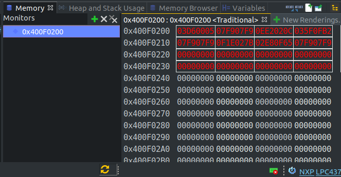

So this is how the FIFO looks like in my debugger, as you can see Matlab correctly display the data from the debbuger.
I also tried with:
    /*FIFO's and descriptors' setup*/
    LPC_ADCHS->FIFO_CFG      = (15 << 1) /* FIFO_LEVEL*/
           | (1); /* 1 = PACKED_READ ENABLED*/‍‍‍
To increase the FIFO_LEVEL, but nothing changes.

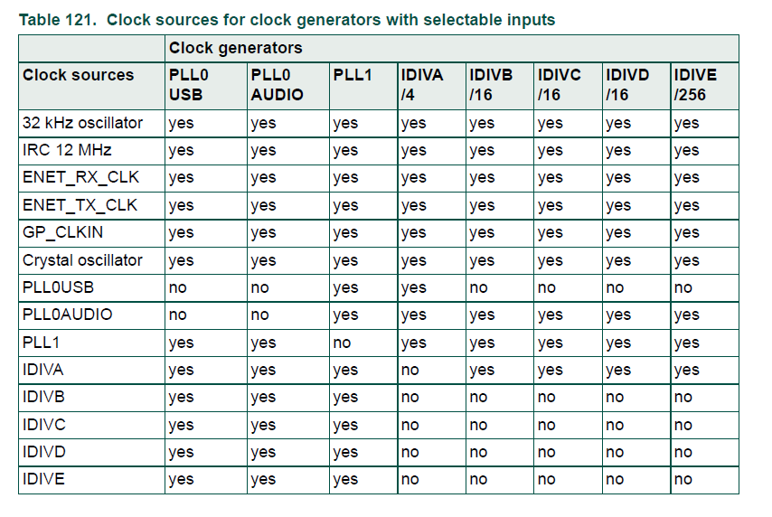

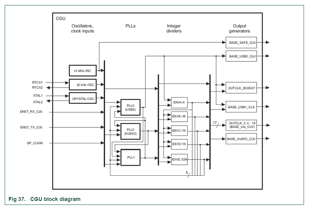

According to the reference manual, you can only connect the second stage of dividers to IDIVA.
Accordingly, you cannot connect 3 dividers in series.

Ray_V
Contributor V
Good catch, I forgot to look at the datasheet for clock sources. But I think it's the opposite. IDIVA is the only divider that can be connected to other dividers (IDIVA must be the source).
11,618 次查看
vitaliylivnov
HI, raymundovelarde‌
That is exactly what I wanted to say. I attach the divider connection diagram, it is easier to understand from it.

Hi @benjamin, thanks for posting your code. I'm trying to use it and display some data in Matlab, but I'm having trouble understanding how do you format the data out put. I tried to force the 2 complement format for the ADC but I still get a dynamic range of 2.1475e+09 (which is absurd) and a non sense graph.
I'm just using your code with this little cycle at the end:
for(int i =0; i<4095; i++)
  DEBUGOUT("%04d\r\n",sample[i]);
Let me know if you managed to reach the 80msps, I need to use this HSADC for a thesis and I'm highly interested.
