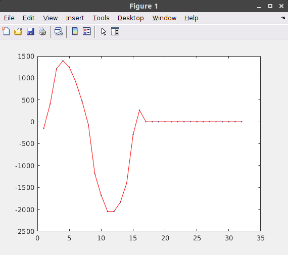

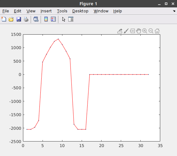

I am currently trying to help a colleague get use the LPC4370's HSADC for a sensor project and am unable to get the advertised 80M samples from a single ADC channel (ADC0).  We are using LPCXpresso and 2 LPClink2's.  We have based the project off the example code in "periph_hsadc".  We're using some ~2MHz test signals to verify performance (# of samples per cycle).
I've thoroughly read through the relevant sections of the Datasheet and User Manual (CGU, HSADC, DMA etc).  I understand the operation of the ADC and it's associated FIFO and also have a good understanding of the DMA settings.  I've reviewed many posts found through google (including every relevant post on here).
Issues:
  • Unable to achieve 80MHz from HSADC.  Using a 2 MHz sine wave and reading for 4095 samples we see ~20 samples per cycle showing that ADC and DMA are, combined, storing 40MHz bandwidth of data.  I assumed this was due to DMA configuration and that ADC was dropping samples due to a full FIFO.  Tried using burst reads from DMA and ending up reading an empty FIFO ~every other sample.  I believe HSADC is currently running at 40MHz even though it reports that it's clock is set to 80MHz.  Code is included below: What could possibly be limiting the sample-rate?
  • As discussed in previous issue we have tried using burst DMA to no avail.  User Manual is pretty clear that you have to use a FIFO LEVEL smaller than 15 so that src burst size and FIFO LEVEL will be the same, but no combination of FIFO LEVEL and src burst has yielded increased performance.  What are the circumstances / settings that DMA bursts will succeed?

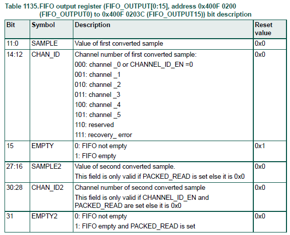

  • We have also tried using Packed mode and run into issues.  Packed mode works fine for ~15 samples after which the packed sample is ALWAYS 0.  What are the limitations on using Packed mode?
Configuration:
Using Cortex M4 processor clocked at 204MHz.
AHB is set for 204MHz.
HSADC:
80Mhz.
Uses two descriptor entires: Table 0 entry 0 is first run with long match time to allow ADC to stabilize, then swap to Table 1 entry 0 with shortest match time and branch to self.
Uses no interrupts and has a FIFO Level of 15 (thought we have tried many other FIFO Levels, other settings depending).
Uses fastest CRS setting and has DGEC configured for 80MHz operation.
DMA:
Configured for transfer of 4095 samples from FIFO_OUTPUT[0].
Uses src and dst burst size of 1 (whenever we have tried to change burst size DMA ends up reading empty FIFO ~50% of samples).
Doesn't use Linked List.
Tried using DMA as Flow Controller AND HSADC, performance doesn't change.
Ben
(And sorry for the code below, tried quoting with syntax highlighting and it hid a large number of the lines)

       LPC_ADCHS->FIFO_CFG      = (15 << 1) /* FIFO_LEVEL*/ | (1) /* PACKED_READ*/;

The problem is that I seems to loose samples.
What I do is: feed to the adc a 11MHz sine wave and start the debug session. I then pause it, export memory from 0x400F0200 to 0x400F0240 (these are the fifout regs). Then I process and parse it in matlab. I spent quit a lot of time on the matlab side and I believe is doing its work correctly.
Here's a picture describing my problem (note that I'm in packed mode).
Since I don't event initialize the DMA in my application, I think this is due to ADC misconfiguration. What do you think?

Then you have to remember that the FIFO only has room for 16 words, since you are enabling packed mode, you have 2 measurements in each word, you may already be doing this but I mention it just in case.
As you read the FIFO, make sure you look at  bits 15-12 to verify that the samples are valid. In your case all should be 0

Thanks for the tip, I did what you suggested.
Unfortunately I still get bad data, missing sample as in the image I posted.
I tried to reduce the sampling frequency (both changing DIV A and B values, and changing the match value for the table's 0 desc 0) and basically nothing changes. Around 30 msps I saw some decently shaped sinewave once, but nothing more. I really don't understand what I am doing wrong at this point
16,196 Views

Thank you a lot man, this little piece of code is very useful to check adc operation I believe.
So my results are good if I set match value to 1.
Here a screenshot: 2MHz signal sample at ~40msps
Unfortunately things screw up if I set the match to 0, and data start to make sense only 4 sample at a time.
I really don't know, but to me it's more likely to be a debug issue/limit than actual ADCHS misconfiguration. Thoughts?
16,196 Views
Ray_V
Contributor V
You might be reading the FIFO wrong. I see you are displaying only 16 valid points. You have enabled Packed Read, so there should be 2 samples per 32-bit word read, so you should have 32 valid samples
