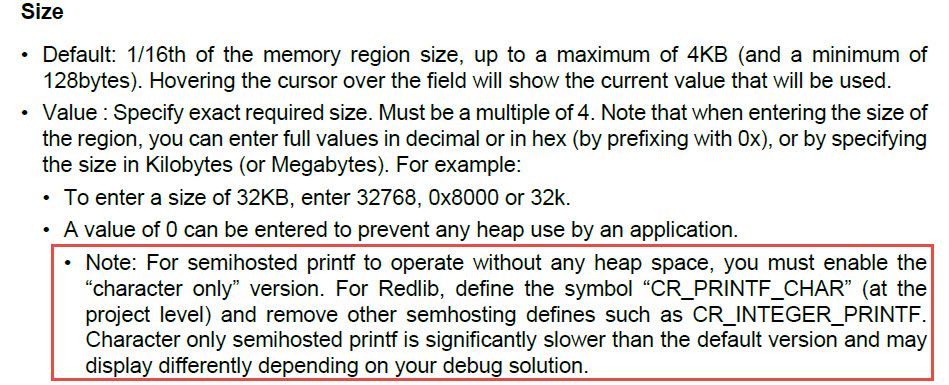

Hi all,
I am working on a LPC804 with MCUXPRESSO.
I am using the Redlib (nohost -nf) - Library support with the following preprocessor defines:
__REDLIB__
PRINTF_FLOAT_ENABLE=0
CR_INTEGER_PRINTF
CPU_LPC804M101JDH24
CPU_LPC804M101JDH24_cm0plus
SDK_DEBUGCONSOLE=0
CR_PRINTF_CHAR
__MCUXPRESSO
__USE_CMSIS
DEBUG
I am using the printf - character by character with only interger only implementation.
It is redirected to work with a uart driver to print in a terminal. In the driver I have a software buffer of 20 bytes, and it works fine if I give it a for loop with 200 bytes, it just waits to have space to put the next byte and I can see all of them on the terminal.
If I use:
1)
printf("Print this sequence that is longer then 20 bytes 012345678910111213141516171819\n\r");
- works just fine
2)
printf("Print this sequence that is longer then 20 bytes")
for(uint8_t i = 0; i < 20; i++)
   printf("%d, ",  i);
printf("\n\r");
- here some times I get HardFault or I get garbage

When the printf has arguments does it still uses malloc() to store the arguments?
1,638 Views
jeremyzhou
Hi Dorin Petre,
To provide the fastest possible support, please refer to the Fig 1.
Fig 1
