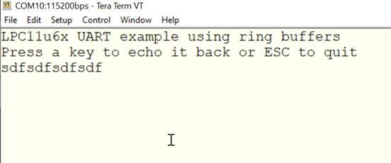

I was able to get an FTDI and test the example directly and I had no issues.
Here are the steps I took:
I imported the following ZIP folders from the LPCOpen folder located in the path of MCUXpresso:
PATH:(C:\nxp\MCUXpressoIDE_11.1.1_3241\ide\Examples\LPCOpen\lpcopen_2_12_lpcxpresso_manley_11u68_fix.zip)
- lpc_board_manley_11u68
- lpc_chip_11u6x
- periph_uart_n_rb

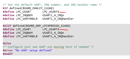

Next I edited the pin configurations for the UART4 and changed the macro to state UART4
Pin configurations:
Build and debug the periph_uart_n_rb project. Using Teraterm I verified the string.

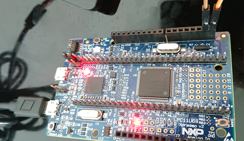

My connections are the following:
The LPCXpresso Board I am using is revision C.
