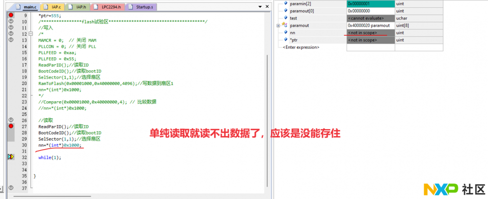

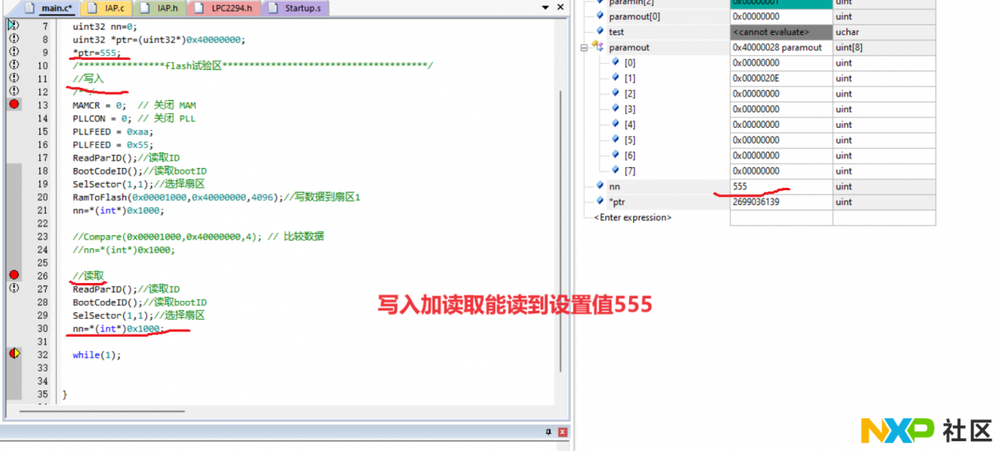

For example, for LPC2136, I can successfully read it by writing to flash first and then reading it, but I failed to read flash alone. So, did I fail to save or read successfully?
my code1:
https://sgw-dx.xf-yun.com/api/v1/sparkdesk/18428095907_4cz0f7mmexport1728876925008.jpg?authorization...
my code2:
https://sgw-dx.xf-yun.com/api/v1/sparkdesk/18428095907_5vdbaammexport1728876927420.jpg?authorization...

Please compare these two codes to help me analyze why the value read is not the same as the value I stored in flash when only reading

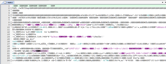

I cannot see the .c files that you provided me, because they are shown as the next image:
Could you share me the .ZIP again?

Last Friday, I already sent you the pictures in this post. Please find last Friday's record and check the relevant code. Please analyze why I cannot successfully save the data in flash using the IAP operation method shown in the picture.

According to the first image that you provided me I understand the next flow code (correct me if I am wrong):
You define a pointer that points to 0x4000000 that is the initial section of the RAM and puts 555 in this direction:
After, you select sector of the FLASH that you will write, and then is used the function called " RAM_to_FLASH", in order to support you better, can you provide me the code inside this function?
Finally, you make a pointer that will point to the FLASH address (0x1000) and you read the value:
However, in the debug section can be observed that the variable called "nn" already have the data that you have written in FLASH.
On the other hand, when you write a new image, the flash is erased, taking this in mind, if you read an address before writing, you do not know what data will have.
Also, in the chapter 29.8 called "IAP commands" explains the function of IAP and explains the "IAP Command Summary" that could be helpful.

Thank you for your reply, but I would like you to answer two more questions. Firstly, in the second image I sent you, I did not erase the 0x1000 address of the flash. Why can't I read the data I wrote in the first image. Secondly, which article is the 29.8 chapter you mentioned in? Can you provide me with the corresponding PDF or website.
