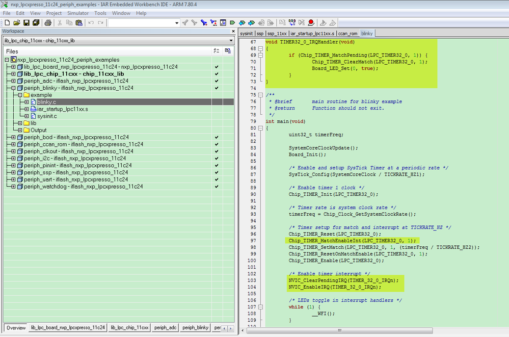

I am currently trying to create and link an interrupt for my UART communication, but I was also not able to figure out how to use an external interrupt earlier. With the data sheet and header file I have, i'm having a hard time finding the method to link a function with an interrupt. With the previous ARM processor I have used (M7) I easily found the address in the data sheet that pointed to the interrupt handler. Some resources are below.
If anyone can give me some pointers I would greatly appreciate it. In regards to this problem or any other topic.

Hi Austin Johannes,
    You can refer to our lpcopen lpc1114 code, and refer to that code to enable the interrupt.
   Now take the TIMER interrupt as an example:
http://www.nxp.com/assets/downloads/data/en/software/lpcopen_v2_00a_keil_iar_nxp_lpcxpresso_11c24.zi...
After configure the according module, and enable the module interrupt, then you need to enable the according IRQ and write the according interrupt service function.
Wish it helps you!
