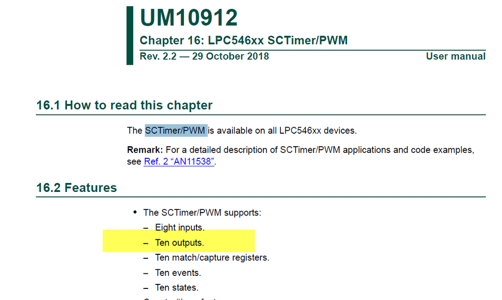

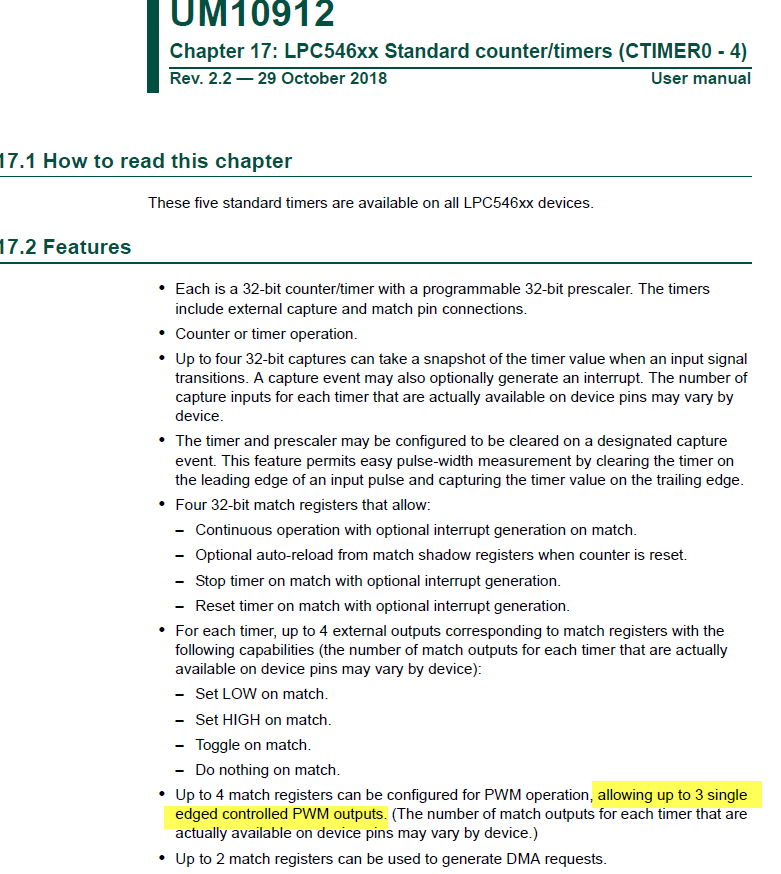

   My customer now is searching for MCU with 25 Channel PWM . And i saw it on selector guide , show 25 - 28 channel PWM  ( Pic 1 ) .
   But I cannot find where show this spec in datasheet or User Manual , Only saws Output ( Pic 2 ) in user manual .
   Could you support me where can find the information like Selector Guide told us ? thanks a lot !!!

yes, it contains 10 channel SCTimer/PWM outputs, plus 15 CTimer PWM outputs. Totally 10+15=25 PWM channels in maximum.
1)  1 SCTimer/PWM which supports 10 outputs.
2)   it also has 5 CTimers, each CTimer supports 3 PWM outputs. Thus totally 5*3=15 output channels

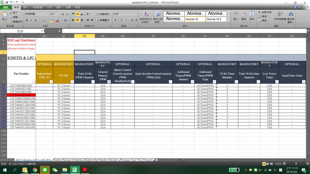

I just checked on line MCU selector, I couldn't see the same data as your screenshot
Product Selector | NXP
Can you please check same on this link? any problem with it?

   I upload the data , as following website .
   It's a selection guide of NXP MCU , Thanks a lot !!
https://drive.google.com/open?id=1LtZsH4FUrowMPIK1I1BocnlTMxBsMs-g
   Any question please let me know , thanks for your help !!

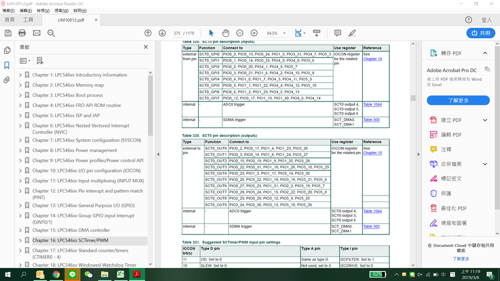

   But now i am searching for 25 channel PWM Output MCU , I saw LPC54605 could meet this request .
   But I don't know how to check ( verify ) How many PWM Output channel in this User Manual , could you help me or teach me how to find it ? thanks a lot !!
