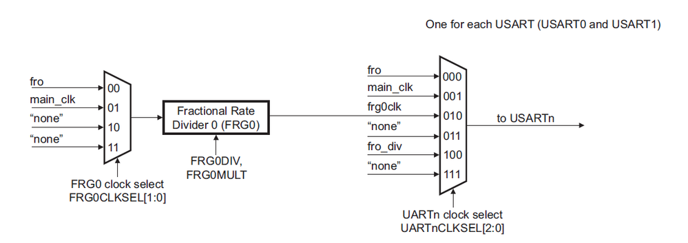

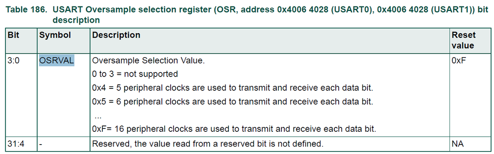

I wish that someone could help me with the terms in yellow at the image below:
What mens FCLK and OSRVAL? How they work and how they interfere at the baud rate?

The OSRVAL value is the number of BRG clocks used to receive one data bit (Fig 1) and I think you can learn the FCLK in the 13.3.1 Configure the USART clock and baud rate, it's very clear (Fig 2).
