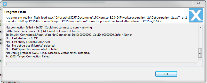

Hello, I am trying to regain access to target MCU. I've read this:
Regaining debug access to target MCU &  ISP Reset over debug.

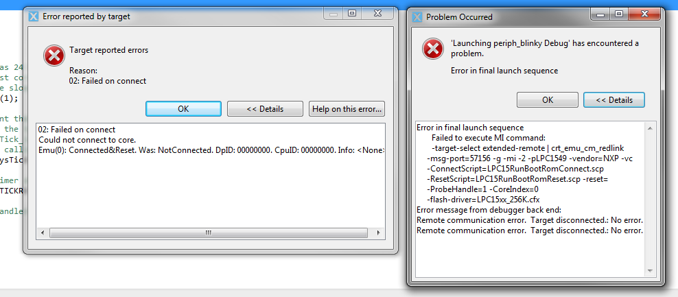

I know that the 1549 is in ISP mode because I'm monitoring the signal activity on the pins and everything goes quiet after pressing and releasing Reset while holding ISP0 & 1. So I get that far. But while entering a debug or flash session I still don't get anywhere.
Debug error: pastedImage_1.png
Flash Error:
Any help with regaining access would be appreciated. There's 3 boards that are locked up from this same error and I've really been spinning my wheels on this for some time now.

When keeping ISP0/1 both low, the LPC1549 uses the uart for programming. You should use flashmagic (Flash Magic - Welcome ) to download you hex file over the uart using an usb-serial convertor.

soledad
Could you please try the following steps?
  1. Power off first
    2. Connect ISP pin to GND
    3. Connect RST pin to GND
    4. Power ON
    5. Wait 5~10 sec
    6. Disconnect ISP pin to GND ----> Keep power ON
    7. Disconnect RST pin to GND ----> Keep power ON
    8. Programming ----> Still power ON
Please let me know if this helps!
