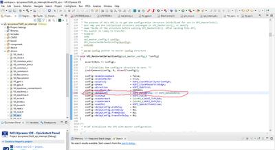

xiangjun_rong
If you want to use 16 bits data transfer, pls modify it as the following screenshot. Or in the main() to modify.
config->dataWidth =  kSPI_Data16Bits; //kSPI_Data8Bits;
In the main():
SPI_MasterGetDefaultConfig(&masterConfig);
sourceClock = EXAMPLE_SPI_MASTER_CLK_FREQ;
masterConfig.sselNum = (spi_ssel_t)EXAMPLE_SPI_SSEL;
masterConfig.sselPol = (spi_spol_t)EXAMPLE_SPI_SPOL;
masterConfig.dataWidth=kSPI_Data16Bits;
SPI_MasterInit(EXAMPLE_SPI_MASTER, &masterConfig, sourceClock);
Hope it can help you

pogi_yogi
I modified the config->dataWidth to 16 bits in the fsl_spi.c file as you did in the screenshot and I'm still having the same issue reading 0x00 0x00. I also tried doing it in the main() function as you suggested, but still same issue reading 0x00 0x00.
