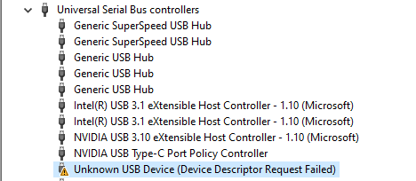

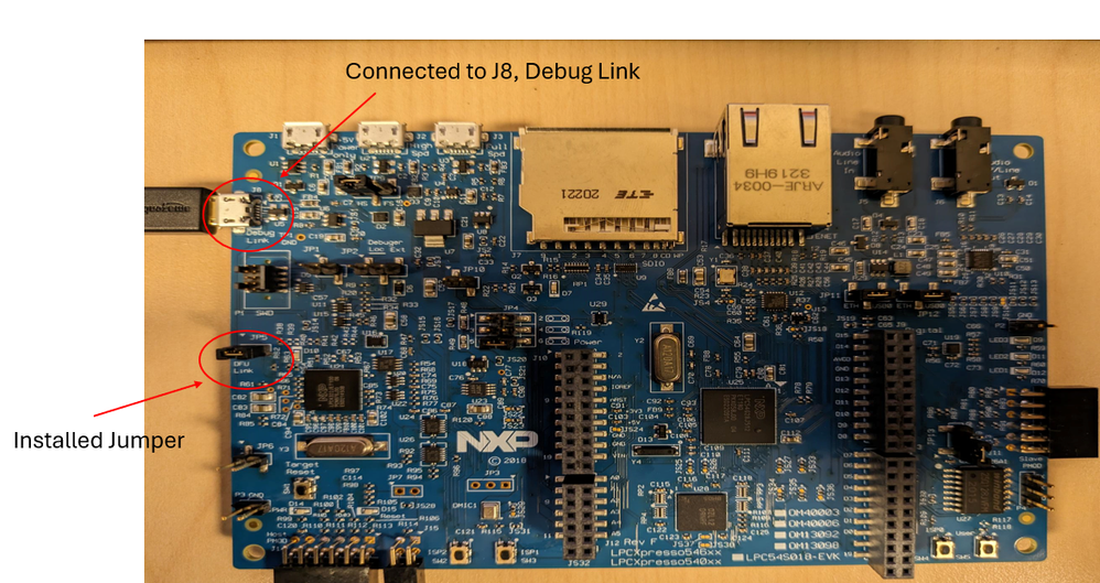

I'm having trouble connecting the NPX board. Below is how I've connected my board. 1.PNG1.PNG

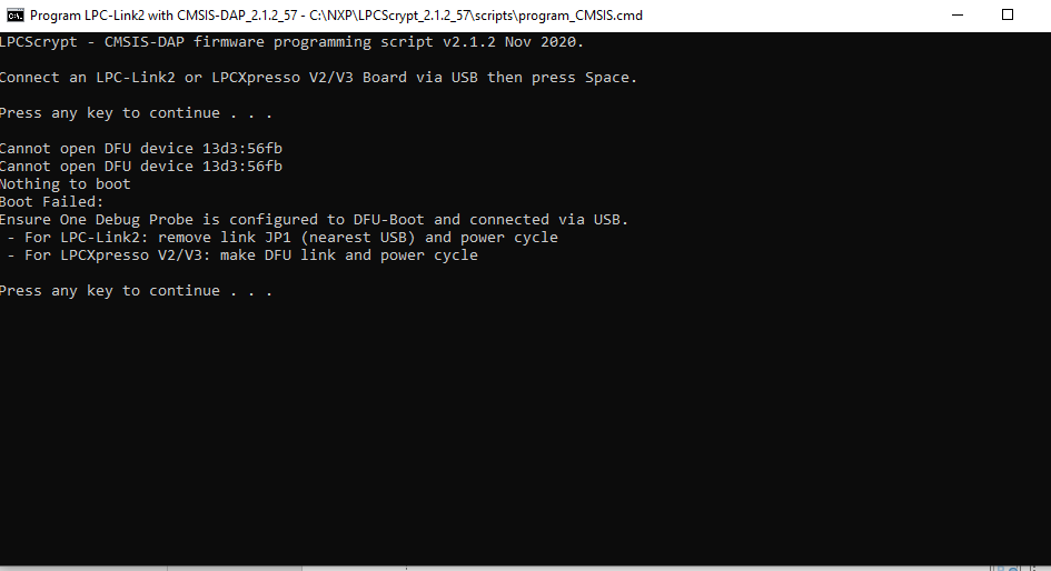

I've tried running LPCScrypt, but I keep getting this error.

This is what I'm seeing in device manager.

Harry_Zhang
Hi @Goku
If you plug in a USB cable, it will provide power to the board and the LED will blink. However, when I saw the picture, your LED did not blink. So please try to replace the USB cable and  new board. If the USB cable is not a problem, it should be that the board is broken.
Hope this will help you.
This looks like the driver is missing. Have you tried to install/re-install the driver from within the "device manager" ?

Goku
Yes, I've already installed the LPCXpresso Link2 USB driver package.
Uninstalling the device and updating the driver, using a different PC, using a different USB cord did not fix the issue.

Goku
Seems like the USB was the issue. Thanks!
