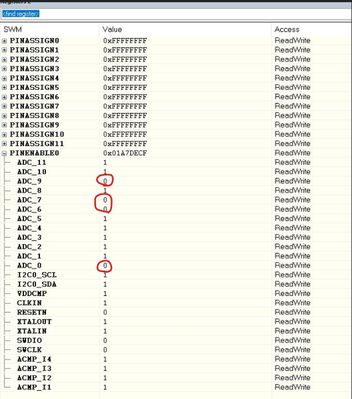

Hi.I've have an issue that a port pin 0.19 on the LPC824 is set to output, it will not respond to instruction to set HIGH or LOW.
It seems that on POR, that the PINABLE0  register is clearing (which ENABLES) ADC_0, ADC_6, ADC_7 and ADC_9.  Other ADC bits are set to 1, which DISABLES the ADC link to the port pin. Data sheet states that the reset state should be 1 for all ADC port pins.
I have tried this on an LPCXpresso824-MAX eval board.
I'm using IAR EWARM, which if you start from the debug enviroment it works OK, but if you start the debug code without IAR, it goes wrong.
I've started the the expresso board without IAR, it goes wrong, used the IAR connect to running target, inspected the PINENABLE0 register, which show the above register bits cleared.
I've tried a simple code example which does the same. A fix is to put a few lines of code to set those bits to 1, but they shouldn't be 0 in the first place? So that extra code shouldn't be required.
Is there something obvious I'm not doing as this would be seen by other folk, but not seen this mentioned on the forum.

mike_hackett
Problem solved!
Turned out to be a silly.
Had some "hidden" bootloader code that got pulled in that fiddled with PINEABLE0 register.
Thanks for your time.

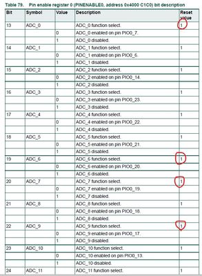

PINENABLE register, for bit 20 that controls ADC_7 at RESET should be SET to One. If set to One, this will DISABLE the link to ADC_7. My test’s indicate that bit is CLEARED to ZERO, which ENABLES ADC_7.   Documentation for PINEABLE0 states that at reset , that bit is SET to One.

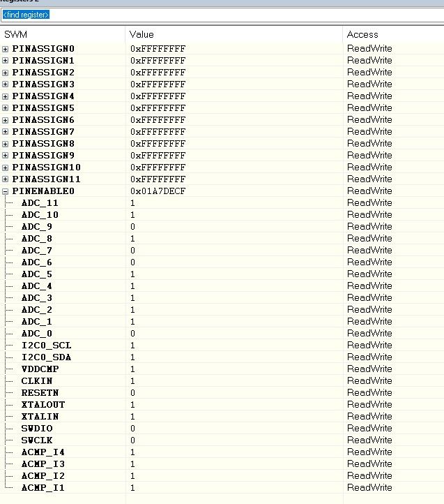

But my quick test program, when inspecting that register that bit is cleared to zero, which the documentation states it shouldn’t be?  I have done this by starting the application, connecting to the running target with IAR EWARM (a great feature), halting the program and inspecting the PINENABLE0 register, as previously shown.
I have managed a “quick” work around by writing to the ENABLE0 register and setting that bit to One, BUT this should not need to be done. Why is it cleared to zero? Is there something obvious I am missing.
Problem also affects ADC_0 , 6 and 9.
I have concern that if register is not properly setting/ clearing the bits at POR, will other registers be doing wrong POR bit setting / clearing?
Grab of NXP data sheet for PINEABLE0

 Screen grab of what IAR EWARM is telling me of the status of PINENABLE0
