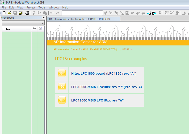

kerryzhou
Hi Shaun,
     Could you tell me the detail information about your project?
     Because I didn't find the CDC_UART in the IAR information center for ARM.
    Which one you find your project in the following examples?
    Waiting for your reply!
Jingjing
