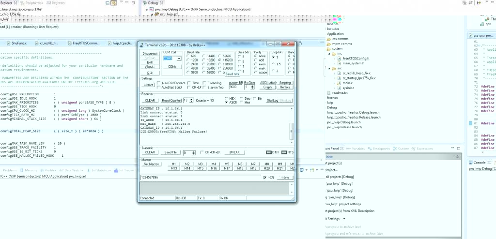

Content originally posted in LPCWare by terrype on Tue Sep 09 00:56:23 MST 2014
IDE : LPCexpresso
BSP; LPC Open 2.10
Board ; LPCexpresso 1769
example use ; lwip_tcpecho_freertos
I modify the example to works as TCP client and it wroks well, I add a extra task which was tested independly and works well.
When boath task run together then started get
1. Malloac fail
2. Increase the total heap size then get Hardfault_Handler error
I attached few images
Q1. How to reduce the lwip tcp tx and rx frame size? also all level of tx and rx buffer

Content originally posted in LPCWare by terrype on Tue Sep 09 15:13:21 MST 2014
LPC espresso version 7.3,
I used heap_3 as it is not thread safe and gave me pretty much same error. LPC1769 have huge RAM in different banks
Q1. How to configure the linker script to use  stack and global variable in 1 bank and heap in different bank?

Content originally posted in LPCWare by lpcxpresso-support on Tue Sep 09 07:37:12 MST 2014
What version of LPCXpresso are you using?
In the first place, I suggest that you see:
http://www.lpcware.com/content/faq/malloc-failure-using-freertos-heap3c-lpcxpresso-tool-chain
http://www.lpcware.com/content/faq/lpcxpresso/heap-checking-redlib
And possibly:
http://www.lpcware.com/content/faq/lpcxpresso/debugging-hard-fault
LPCXpresso Support
