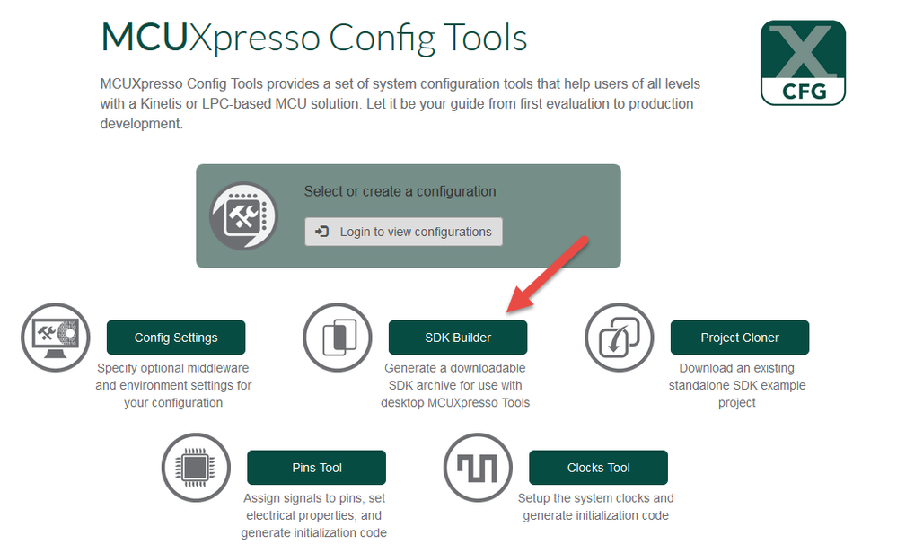

I think you use the LPCOpen library, and LPC54102 also has the KSDK library which is a new library, you can try it out.
Whether you can illustrate the steps to replicate the issue in details.
Welcome to MCUXpresso | MCUXpresso Config Tools

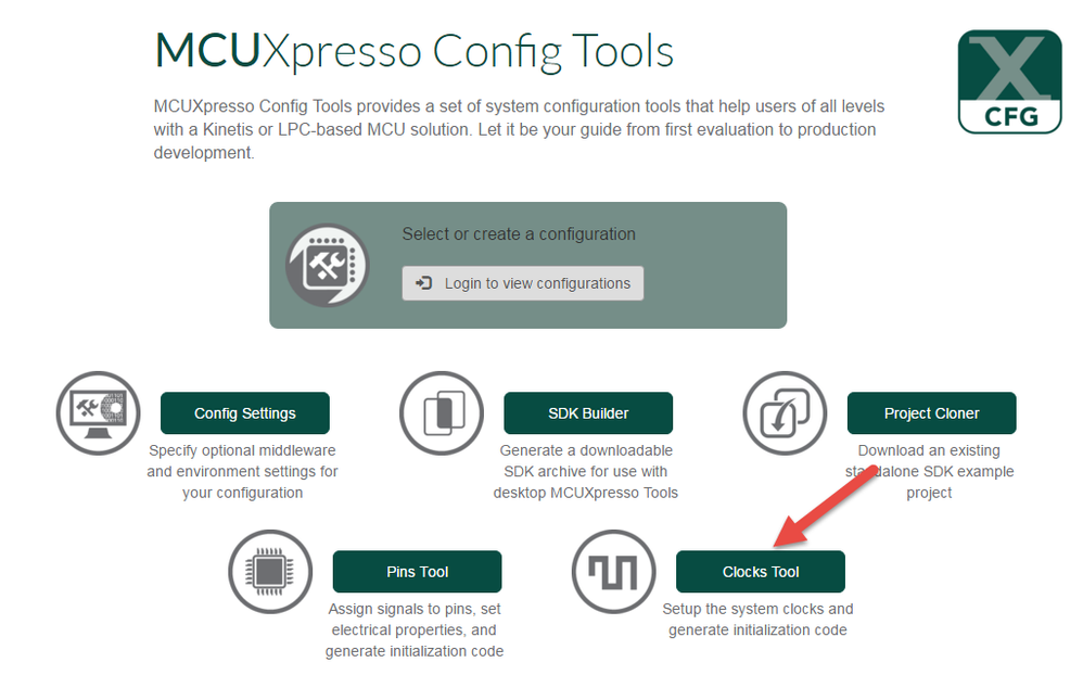

I'd highly recommend you to use the visualize tool: Clocks Tool to configure the clock of the LPC54102.
