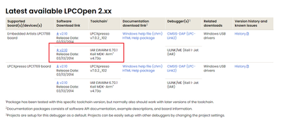

Harry_Zhang
Hi @aus_swsol
You can access to the NXP lpcopen website
LPCOpen Software for LPC17XX | NXP Semiconductors
And download the lpc1788 Keil packet.
You can modify the project according to your needs based on this Keil project.

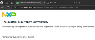

aus_swsol
Hi Harry,
This is what happened when I clicked
Can you please provide me the latest stable SDK with example for LPC1778FBD208?

Harry_Zhang
Hi @aus_swsol
Sorry, our LPCopen official website has some issues, we will resolve this problem as soon as possible.
