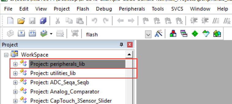

I just tested LPC845-Example-Code-Bundle-Keil on my side. I didn't see build error.
Please note the library projects (*_lib) must be individually built before the example projects will build.
After building these two lib individually, you should have no problem build other project.

vidhya1
Thank you sir, it worked.
