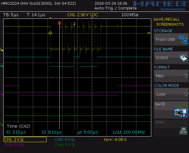

I m having a little difficulty trying to return a register value from a SPI device connected to an LPC5411 board using the fsl_spi.c driver. From looking at the scope I seem to have clock and MOSI signals but I don't think I m getting anything back on the MISO line. I have attached the screen grabs of the scope. I have been working with examples provided by the following sdk. SDK_2.2.1_LPCXpresso54114. I m a little uncertain if slave code in the example spi_polling_transfer.c is necessary when talking to an external device. My assumption is that i can just use the SPI_MasterTransferBlocking() function to send a byte value and the device just returns the requested register value. The code is as follows. Note: I m using a GPIO pin for the slave select line where its pulled low when writing and pulled high when finished writing to device. So I have a few questions.
If I m not using slave select using masterConfig.sselNum but instead use a GPIO pin, does the fsl_spi need to know this?,
Can a single byte value be sent via SPI_MasterTransferBlocking() and should this automatically fill the rxData array or is a dummy byte necessary?
Can slave code be ignored? Is the SPI_SlaveInit() code necessary?
Any help would be greatly appreciated. Thanks.

   Could you please send me a picture contains the SPI bus: spi_clk, spi_mosi, spi_miso, spi_cs together?
   It will be useful to my analysis, from your description, it seems the MISO data is not correct, so I need to check the spi bus at first, if the spi bus data is correct, then the code may have problem, otherwise, if MISO wire don't have data, it means your slaver didn't give out the correct data.
   Please give me the spi wave with 4-CH oscilloscope, or the logic analyzer.
Kerry
9,020 次查看
puddletowntom
Hi Kerry,
I have attached a picture of the 4 channels together. Channel 1(yellow) is the SPI clock, channel 2(blue) is the SPI MOSI, channel 3(purple) is the chip select and channel 4(green) is the SPI MISO line. It appears the chip select is pulling low when it should be when there are pulses from the clock. Also, changing the byte value on the MOSI line seems to be changing correctly.
I did notice that my clock signal is only 8 cycles. The device I'm using is a pressure sensor called LPS22HBTR. It seems that the clock should be 16 cycles but i m not sure how I make the clock do this.
Thank you

kerryzhou
Hi Ronan,
    Your wave seems have the problem, please download the newest LPC54114 SDK2.3.0 from this link:
Welcome | MCUXpresso SDK Builder
  After you download SDK_2.3.0_LPCXpresso54114, please go this folder :
SDK_2.3.0_LPCXpresso54114\boards\lpcxpresso54114\driver_examples\spi\polling_b2b_transfer\master
I run it, didn't connect the slave, you can find the master SPI wave is:
Then, you just need to modify the xfer.dataSize, and srcBuff data to meet your slave demand, then test it.
Wish it helps you!
Kerry
