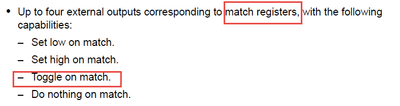

Hello @perdrix
Do you just want to toggle GPIO? How about use match function of timer?
Alice

Woohoo! I think I got Match working:
I user Timer0 and MR1, setting up as follows:
LPC_PINCON->PINSEL7 = (2<<20); // P3.26 becomes MAT0.1
LPC_PINCON->PINMODE7 |= (2 << 20); // Pin 3.26 == MAT0.1 no pull or pull down
LPC_SC->PCONP |= 1 << 1;      // Power up Timer 1
LPC_SC->PCLKSEL0 |= 1 << 2;   // Clock for Timer 0 = CCLK
LPC_TIM0->MR1 = 9;     // Approx 100ns
LPC_TIM0->MCR = (1 << 4);			// Reset on MR1 (no interrupt)
LPC_TIM0->EMR = (1 << 1) | (3<<6);	// Drive MAT0.1
// Reset Timer 1
LPC_TIM0->TCR = 0x02;
LPC_TIM0->TCR = 0x00;
LPC_TIM0->TCR |= 1 << 0;      // Start timer 1
The only odd things are:
  1. I needed to set MR1 to 9 for an interval or 100ns when I expected to have to use 10.
  2. The amplitude of the signal on that output pin was 0.4Vp-p when I expected 3.3V.
Can you clarify those issues for me please?
Thanks, David
