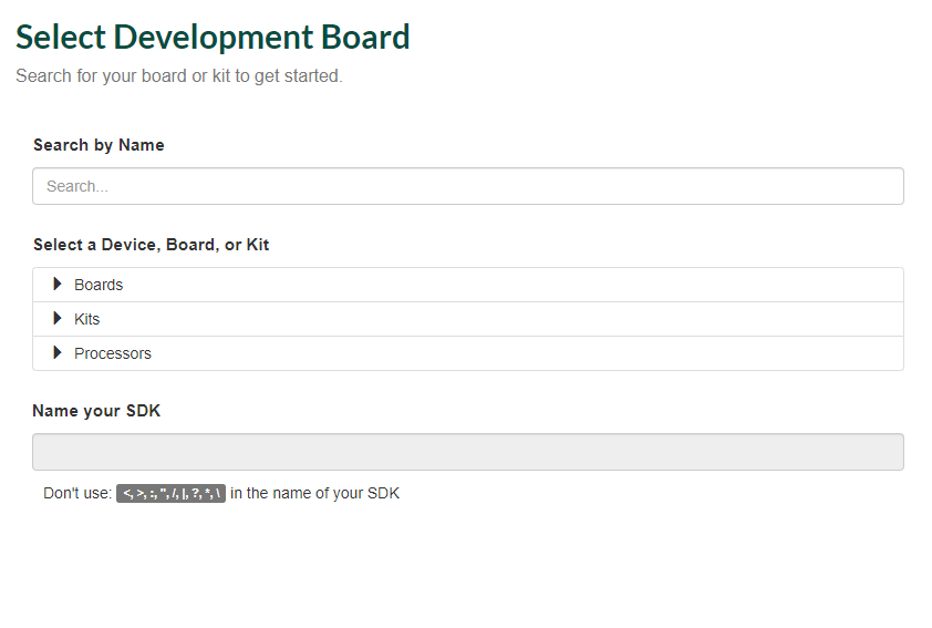

In order to check the examples for all peripheral that you can work with uing your LPC board. You need to download the SDK in our MCUXPresso SDK Website. If you are using the LPCXpresso54618 board then you can find it by clicking on "Select Development Board".
You will see the page come to this section, you can search for the microcontroller you are using or the development board you are using. In my case I have the LPCXpresso54618, so I search that.pastedImage_3.png
If you have a different board or a custom board you can search by the microcontroller name only.
Once you have selected your board you will see a button on the right hand side that says "Build MCUXpresso SDK". Next you will have your SDK builder, for the optional middleware I suggest to select all.pastedImage_7.png

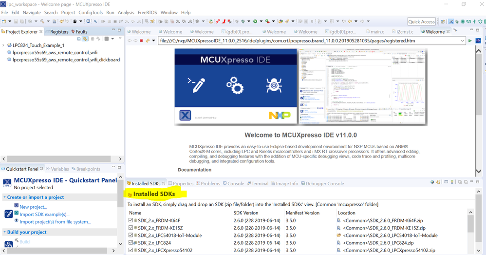

Once downloaded you can drag this zip folder to the Installed SDKs window, as shown below:

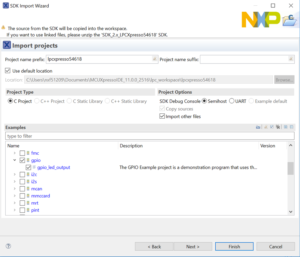

Next to view the examples you can click on "Import SDK examples" in the Quickstart Panel.
Here you will find all the examples that have been created for different purposes. The one I recommend you take a look to see how GPIO works are the following under driver_examples > gpio:
This uses both led and switches.

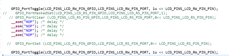

I've been checking your code with detail to see how you are implementing the GPIO peripheral. I can see that the switch and led work fine as it is from the example in the SDK.
I can also see that you are using an LCD display to print some text. I have some observations that may help in successfully using GPIO for your LCD.
First I'd like to understand what it is your achieving with the following toggles. The reason I am asking is because prior to this I do not see if you are initializing this with a set value, like the led is in the SDK example. So if you apply a toggle to an unknown state pin you might not be seeing what you are expecting.
In general I can see you have an idea of what you need to do. It is just a matter of debugging to find where the root issue is that is preventing you from seeing the results.
If you can provide the LCD display that you are using (the part number). This way I can verify the sequence to write a character it will help me understand what you are trying to achieve.
