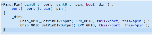

I found a really shocking misbehavior while developing a project for the LPC1114 chip under LPCXpresso IDE using such a library. In short: a calling to the function Chip_GPIO_SetPinDirOutput() always calls Chip_GPIO_SetPinDirInput(), WTH!!. Then I tried the more general function Chip_GPIO_SetPinDIR(), which in turn did what was expected.
More about the project:
  • LPCXpresso v8.2.2, Linux Mint Cinnamon 18.3
  • The project is under C++, no optimization at all, maximum debugging (-g3), -std=gnu++11, newLibNano -nohost
  • LPCOpen library settings: optimized for size, no debug information, -std=C11
I captured some pics so you see the issue closer:
  • -28.png, L127: Calls the constructor.
  • -13.png, Constructor's body. Whenever _dir is true, Chip_GPIO_SetPinDirOutput() should be called.
  • -51.png, L167: Weirdly the function Chip_GPIO_SetPinDirInput() is invoked, so the pin is always set as input regardless the user's wishes.
As far as I now, LPCopen 2.0 release library is the last (and old one) for this chip. Any ideas?

    I have check our LPCOpen 2.0 library for lpc11c24,  I didn't find this definition:
My code is download from this link:
LPCOpen Software for LPC11XX|NXP
I don't know where you find it, or you write it by yourself?
I think you can debug this function, check _dir, when you intput :  Pin::output, check ouput value, and the _dir value if you want to use Chip_GPIO_SetPinDIROutput function, _dir should be 0. Check your output, is it 0?
I think the problem may caused by this Pin::Pin function, or the value of your output.
Please check it again on your side.
Any updated information, please let me know.
Kerry

The code in C++ is mine. What is important here is that the library function Chip_GPIO_SetPinDirOutput()  always calls Chip_GPIO_SetPinDirInput(). I'm using the library you've mentioned.

So, are you saying that in your Pin:Pin method always calls SetPinDirOutput, regardless of the stat of _dir? Or are you saying that the LPCOpen function calls the wrong thin?
if it is your code, can you provide an example of how you invoke the method!
