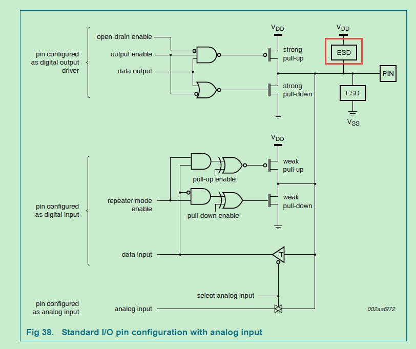

Hello all,
(Device: LPC1778fet180)
we want to connect a data line with a high voltage level (above 5 V) to P1[1]. To keep the circuit as simple (and cheap) as possible we have the idea to use a serial resistor - to limit the current - and the protection circuit on the chip - which limits the voltage.
  1. Is it allowed to drive the input with a current source and let the protection circuit "adjust" the voltage?
  2. If yes: Wich current is allowed?
  3. I fond in the datasheet the value I_latch (I/O latch-up current). What is the special meaning of it (What current under which condition)?
Thanks in advance,
Andreas

Unfortunately, LPC product team doesn't have ESD diode allowed current data.
Mike

On normal inputs there is a diode to Vdd and a diode to Vss. So any input current goes into the power supply through these diodes. So if the microprocessor is consuming LESS than your input current, the current ends up in the power supply where a series-type voltage regulator can't do anything about it, and then you have an excessive power supply voltage.
The two diodes in series give you a PNPN junction structure just like a thyristor, so excessive current through either of the diodes is like the gate current of the thyristor which then latches ON.
5V tolerant inputs are different - I asked what the protection circuit consisted of and got no response (no surprise there!)
I think it must be like a zener, but I don't know for certain, so I would be much happier using my own external zener.
I suppose you could use the input pull-down option to cancel your input current, but as that can vary from 10uA to 100uA the input voltage could end up anywhere, so that's not a great idea either.
If you do use an external zener, don't forget that the external voltage must get below 1V for it to be certain to read a logic zero.
If you know the possible range of your external voltage, then it is best to use a potential divider. That way you can be certain of your logic 1 and logic 0 thresholds. So it's cost you ONE RESISTOR!
The current through the divider will be determined by the pin input capacitance and the speed that you require.
Maybe you need a capacitor in parallel to remove any transients?
If you don't know your external voltage, but just know that it's larger than 5V, then it will require a little more thought; and perhaps more than one extra component!

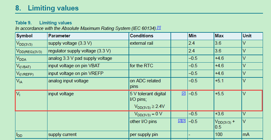

Regarding the 5V inputs I also guess that there is a zener (3.6V) used - because the max. input voltage @ Vdd=0V is 3.6V. But I hope we will get a answer whats really behind it (Or which capabilities the circuit has).
TS: From LPC1778 datasheet, the 5V tolerance I/O Max. input voltage is +5.5V with below table:
There doesn't allow the 5V tolerance I/O pin input voltage more than +5.5V.
2. The I/O latch-up current 100mA is the ultimate I/O pin current for very short time. If there I/O pin current exceed 100mA for a very short time, the LPC1778 chip will be damaged.

1. So the protection circuits aren't able to sink a current? At my point of view the max. V_I voltages are these Voltages, where the protection circuit isn't working (sinking current). If the V_I increases above this value somewhere the protection circuit begins to work and draws current - but wasn't damage. If my point of view is correct - which is the maximum allowed current?
2. What is the source/the cause of the latch up current?

1. For LPC1778 datasheet doesn't provide the DC injection current value, I need to check with LPC product team about that parameter. With DC injection current value, we could calculate the serial resistor value to protect the diodes heating in pads. I will let you know when there with any comments.
2. A common cause of latch-up is a positive or negative voltage spike on an input or output pin of a digital chip that exceeds the rail voltage by more than a diode drop(such as: ESD issue). Another cause is the supply voltage exceeding the absolute maximum rating, often from a transient spike in the power supply( such as: I/O input voltage exceed VDD-GND range).
