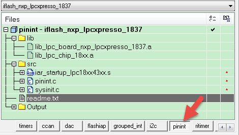

I'd highly recommend you to refer to the pinint demo which illustrates configure a pin interrupt as a falling edge interrupt.
And you can download the LPCOpen through the link below.
LPCOpen Software for LPC18XX|NXP
