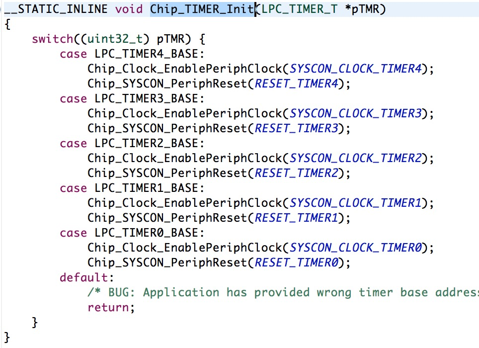

This is the function 'chip_TIMER_Init' in LPCOpen. As we can see, the switch-case statement seem to be expected to add 'break' as the end of one case. Otherwise, the timer0 will be initialize unexpected when I use this function for timer1.
If a correction for this glitch can be  added into next version of LPCOpen, I will appreciate it very much.

Could you please mention the LPCOpen version you are using?
Could you please mention the device you are using?

The LPCOpen Version is v3.00c.001 for  LPC5411X.

I reported this to our development team.
Thank you for your feedback.
