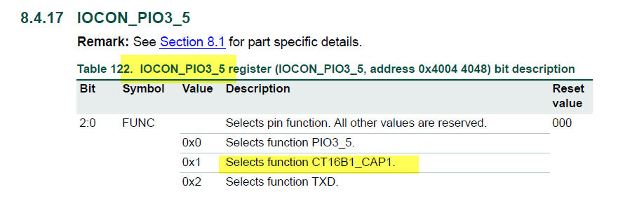

My goal is to measure a sensor frequency in between 50kHz to 120kHz for a high resolution. As the first step I want to divide this frequency to be able for handle on the LPC111x.
Therefore I am using that signal as an external input on PIO3_5 to the Timer/counter using the Timer/Counter setup:
LPC_IOCON->PIO3_5     = (LPC_IOCON->PIO3_5 & ~(0x3FF)) | 0x21;  //set up pin (sec 7.4.17)  (no pull up, Hyst enable)
 LPC_SYSCON->SYSAHBCLKCTRL |= (1<<7)|(1<<16)|(1<<6);  //enable clock signal CT16B0 (sec 3.5.14)
LPC_TMR16B0 ->PR                         = 0;               //no preclear (sec 18.7.4)
LPC_TMR16B0 ->MR0 = 200;         //compare-counter(sec 18.7.7)
LPC_TMR16B0 ->MR1 = 0;
LPC_TMR16B0 ->MCR = 0x03;        //TC Reset on MR0 Match, enable Interrupt (sec 18.7.6)
 LPC_TMR16B0->EMR  = 0x30;      //do nothing (sec 18.7.10)
LPC_TMR16B0 ->PWMC = 0;        //no PWM Mode, (sec 18.7.12)
LPC_TMR16B0 ->CTCR = 05;                            // (sec 18.7.11)          counter mode on rising edge, CT16Bn_CAP0
LPC_TMR16B0 ->TCR                        = 02;          //reset (sec 18.7.2)
LPC_TMR16B0 ->TCR                        = 01;          //GO (sec 18.7.2)
For the first test I am reading in a polling loop the  LPC_TMR16B0->TC and expecting random values, but getting just zero.
I am not going to use the Capture.
May be I am not understanding some basics in using the external Counter input.

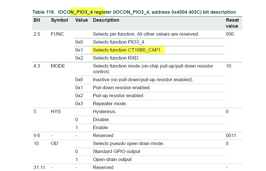

Hi Bernd,
    You are using the wrong input pin.
   From your code, I can find you are using TMR16B0, but PIO3_5 is the CT16B1_CAP1 pin.
So, actually you can use the PIO3_4 pin, this is the CT16B0_CAP1 pin.
Please modify the pin, and try again, I suggest you enable the internal pull up resistor.
Wish it helps you!
Kerry

bernd1
I am sorry for my delay, was out for 2 weeks.
I have changed the pin and setup as recommended, but the getting the same result.
I also can read the toggling pin 3_4.
Are there some other suggestions?
Best Regards

bernd1
Hi Kerry,
thank for the real fast answer.
here is the extract of my from the priject:
void initCTR() // Sensor-input 50...120kHz
#define DYN_STAND (3,4)
LPC_IOCON->PIO3_4 = (LPC_IOCON->PIO3_4 & ~(0x3FF)) | 0x21; //set up pin (sec 7.4.17) (no pull up, Hyst enable)
LPC_SYSCON->SYSAHBCLKCTRL |= (1<<7)|(1<<16)|(1<<6); //enable clock signal CT16B1 (sec 3.5.14)
LPC_TMR16B0 ->PR = 0; //no prescaler (sec 18.7.4)
LPC_TMR16B0 ->MR1 = 0; //
LPC_TMR16B0 ->EMR = 0x30; //do nothing (sec 18.7.10)
LPC_TMR16B0 ->CTCR = 05; // (sec 18.7.11) counter mode on rising edge, CT16Bn_CAP1
// LPC_TMR16B0 ->CCR = 00; // (sec 19.7.8)
void TIMER16_0_IRQHandler(void)
LPC_TMR16B0->IR = (1<<0); //Clear MR0 Interrupt flag
if (GPIOGetValue DYN_STAND == 1) GPIOSetValue TestPin;
else GPIOclrValue TestPin;
return;
initCTR();
NVIC_EnableIRQ(TIMER_16_0_IRQn);
loop for
sprintf(String,"Count: %04X %1X",LPC_TMR16B0->TC, GPIOGetValue DYN_STAND);
Print(String);
