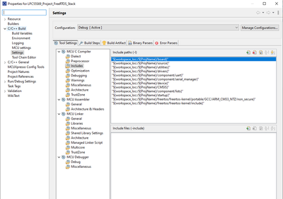

Hello Team,
I am trying to build FreeRTOS module using MCUXpresso IDE, but the build is failing.
All the respective header files exist in the stack. The header file path is set in the includes.
"portmacrocommon.h" is already present in this path "freertos\freertos-kernel\portable\GCC\ARM_CM33_NTZ\non_secure"
Please find the snapshots below for your reference.
Can someone please let us know, what is still missing?

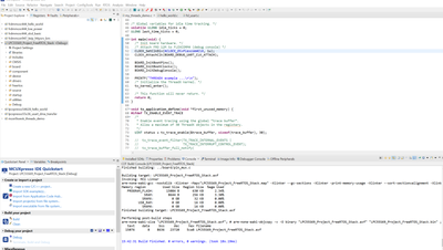

sushmasan
Finally, I was able to compile the FreeRTOS component.

Hi @sushmasan
Sometimes, using relative paths can cause issues. As a test, try adding the absolute path to the non_secure folder containing portmacrocommon.h directly in your project settings to rule out any issues with relative paths.
If your problem has not been resolved, can you share your project?

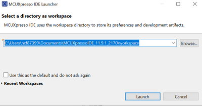

Harry_Zhang
Hi @sushmasan
I mean that change the MCUxpresso workspace, not the workspace for FreeRTOS.
When you open the MCUXpresso, It will prompt you to choose a workspace.
You can create a new workspace.
Hang

andrewsglenn
What happens if you set the path in the Includes tab of "Properties->C/C++ General->Paths and Symbols" ?
