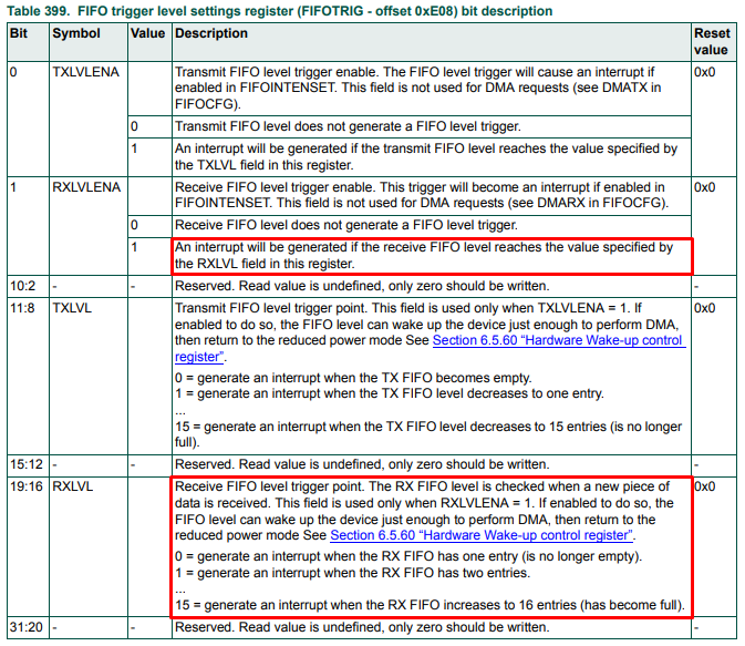

So I'm looking to delay a task that calls the asynchronous int USART_RTOS_Receive(usart_rtos_handle_t *handle, uint8_t *buffer, uint32_t length, size_t *received) method until the received count equals the desired length.
The function returns immediately and received tells you how many characters were read but I need a blocking version or a version that delays the task until the read is complete because the next part of the task depend on the data being read.
Is there a built in way to do this or what would the best way to go about implementing this be?

Hello Marc Bressler,
I think there is an easiest way to receive certain amount of characters by using the UART FIFOS. Please refer the user manual https://www.nxp.com/docs/en/user-guide/UM10914.pdf  chapter 24 sections 24.6.10 to 24.6.19.
As you can see in the image  below you can configure the RxFIFO to trigger an interrupt when you reach the desire length which can go from 1 character to 16 characters.
Hope it helps!
Victor.

mbressler
Hello, this method definitely seems like the right direction for my use case. Do you know if it plays nice with RTOS tasks?

victorjimenez
Yes you shouldn't have any problems on working with this. I recommend you to take a look into the example lpc_usart_interrupt_transfer of the SDK. Although this example doesn't use RTOS is definitely a good starting point for your project.
Hope it helps!
Victor.
