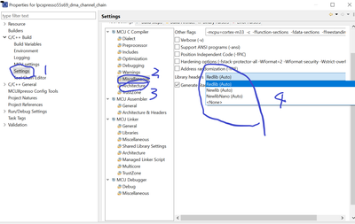

Hello everyone, my code used to work fine, but I changed the chip and added some new lines to my code. I used to read two temperatures (LM35) from ADC and I want my data to be float. Now instead of dot it shows temperatures with something similar to a y with two dots on top of it. For example instead of showing 25.3 it shows something like 25y3. I can show the temperatures in integer correctly, but when I change the data to float it shows something weird like 25y3. It used to work fine. I added my code and the screenshot of the bluetooth app. Btw my chip is LPC1768

I think you can consider to change the library or the float number format as the following screenshot.
1)change the library
Setting->Miscellaneous->library header
2)change the float format
Setting->Architecture->Floating point.
Hope it can provide a clue.

Thank you for the reply. Actually, I tried that with LabVIEW too. Problem wasn't with the Bluetooth terminal. Interestingly, it works fine when I use only uart3, but when I activate uart1 it messes up float numbers. I could send them as uint and instead of sending the data in float I sent them in uint and devided it by 10 in LabVIEW, so that I can see the data in LabVIEW like float numbers. So, I bypassed this problem, though still it's good to know why activating uart1 messes up the data in float
Hope it can help you
XiangJun Rong
