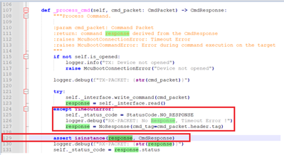

I'm using KW45B41Z with VID:PID=1FC9:0143 and SER=E2KIV02VWSX53.
My intent is to Flash and/or Erase, Set parameters, etc... using
spsdk.mboot.mcuboot.py and other pieces of code from the spsdk integrated within python 3.12 GUI.
But when running the GUI Erase function calling mcuboot flash_erase_all() for example, I get this kind of errors:
Exception in Tkinter callback
Traceback (most recent call last):
File "c:\Python312\Lib\tkinter\__init__.py", line 1948, in __call__
return self.func(*args)
File "C:\_dev\spsdk\examples\bmw-poc-gui.py", line 1133, in <lambda>
erase_board_button = tb.Button(blhost_frame, text='Erase Board', command= lambda: self.board.erase_board(self.vid_pid) , bootstyle = INFO)
File "C:\_dev\spsdk\examples\bmw-poc-gui.py", line 404, in erase_board
mb.reset(reopen=False)
File "C:\_dev\spsdk\spsdk\mboot\mcuboot.py", line 730, in reset
status = self._process_cmd(cmd_packet).status
File "C:\_dev\spsdk\spsdk\mboot\mcuboot.py", line 129, in _process_cmd
assert isinstance(response, CmdResponse)
AssertionError

Do you have full logs?
I checked the logs you provided, it seems it raises " No Response, Timeout Error !"
Christine.
