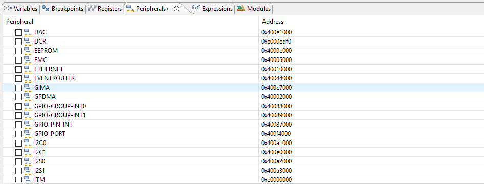

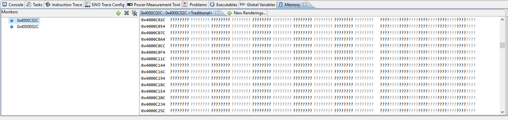

One other strange data is that I can not read in the memory tab of the debug perspective the FMSW0/1/2/3 values of the Flash bank A (0x4000 C02C address) or B (0x4000 D02C address), but I can read on address of others modules like timers or uarts:
Besides, in the Peripheral tab of the debug perspective does not appear the FMC peripheral, but appears of the others peripherals:
It seems like this model hasn't this Flash Signature Generation Module. But that is very rarely. Has anyone any experience with this module in this MCU model? Any other suggestions?

Peripheral tab doesn't contain FMC module, however, you can review these register in the memory tab.

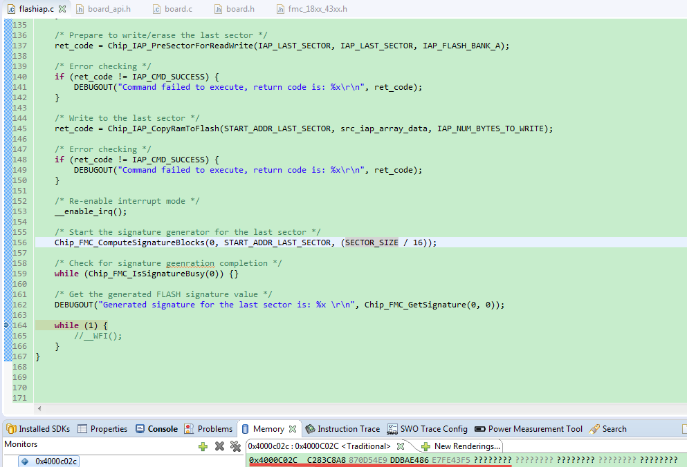

javiervallori
Hi Jeremy,
thank you for the answer. I try again on a new and simple test on periph_flashiap demo.
I start running just the periph_flashiap, getting exactly the same result you get:
 Generated signature for the last sector is: c283c8a8
After that, I made a very simple modification on that project. Apart of Erase and the CopyRamToFlash opertation on the last sector (sector #14), I just erase the penultimate sector WITHOUT the CopyRamToFlash operation. The result of the signature generation in both sector should be different, but I get the same:
  Generated signature for the penultimate sector is: c283c8a8
The code I executed is the same one as in the periph_flashiap with few modifications marked in red :

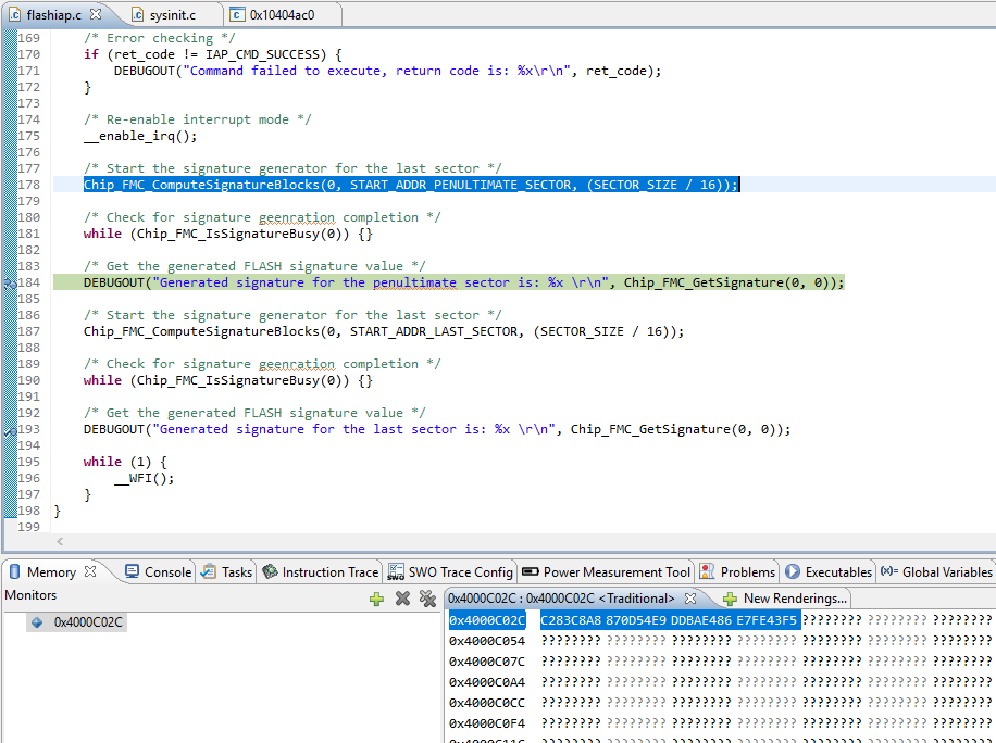

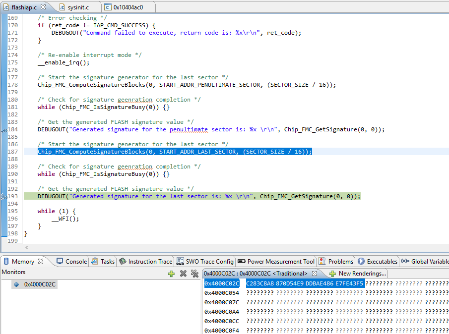

javiervallori
Hi Jeremy,
I show you the signature of the sector 13 (IAP_PENULTIMATE_SECTOR) as you did:
and the signature of the sector 14 (IAP_LAST_SECTOR, the one of the demo example):
As is previously indicated in the code I copied, the IAP_LAST_SECTOR has a copy of the src_iap_array_data array, but not the IAP_PENULTIMATE_SECTOR, wich has simply been erase. So the signature should be different, but it isn't.

jeremyzhou
Hi Javier Vallori,
I've replicated the phenomenon, it seems so weird.
I'll do more testing later to dig much deeper.
