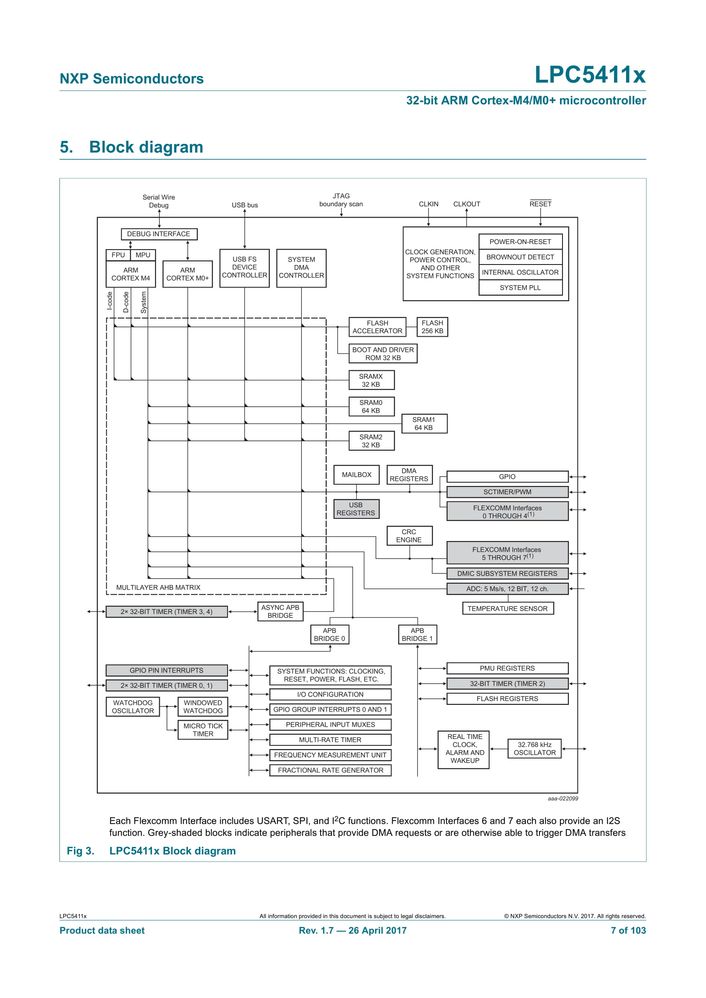

Hello to all,
While going through an architecture of the LPCXpresso 54114, I have read about a memory unit present just before the flash memory, namely Flash accelerator. So, is there any piece of code to make it turn on or off??
Thanks a lot in advance,
Himanshu

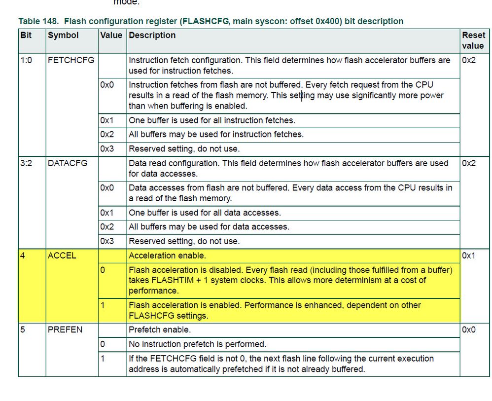

Hi HIMANSHU DOSHI,
     The acceleration can be enabled in register FLASHCFG[ACCEL], you can find the according information from the user manual UM10914:
More details, please refer to chapter 6.6.4 Flash accelerator functional description.

kerryzhou
Hi HIMANSHU DOSHI,
Kerry

kerryzhou
Hello Hlmanshu,
  Please try this:
  SYSCON->FLASHCFG &= ~(1<<4);
Wish it helps you!
Kerry

himanshudoshi
Hello Kerry,
Thank you very much for your reply. I have tried as per your suggestion. But, now there is a small issue occurring.
The issue is even when I have replaced 1 with any other number for example 0 or 100 or 700. There is no change observed in the power consumption. Also, when I have removed ~ sign, no changes observed.
Why is it so? Can you clarify me a bit?
