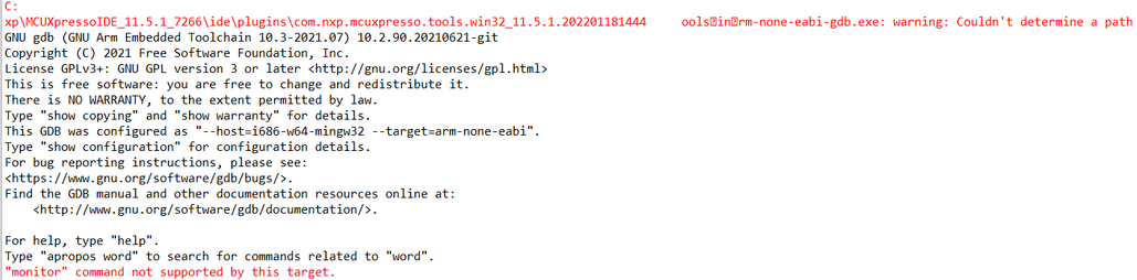

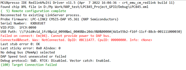

Hi, I am debugging the LPC 32bit arm controller in MCUXpresso IDE on ISP mode with LPC-Link2 kit
I am always getting no power in DAP bus even though I have provided external power source to the controller.
Need the needful help to come out from this query.
Thanks in adavance.

hi @CarlosGarabito could this problem is cause from pull-up of 4.5k ohm on ISP, SWDIO, SWDCLK, RESET pin as starting it was able to program the mcu.
Data sheet mention the range of 10-100k ohm, could you please figure out the problem.

So, are you using a custom board?
2,300 Views
VishalThakur11
yes
2,281 Views
CarlosGarabito
In this case, I can't replicate your error having you a custom board, so I suggest that try to do the same in a some evaluation board of us, and see if you obtain the same error. I suggest to that see the pdf Hardware Development Guide for your MCU to see if some hardware that you are using have a mistake

VishalThakur11
hi @CarlosGarabito
I am using windows 11 system
MCUExpresso is able to display lpc link2 connection via usb, there is no connection issue.
When ever I tried to debug the program usually it show the Failed on connect: Em(04). Cannot provide power to DAP bus.
Debugg console is displaying the error message.

CarlosGarabito
Hi @VishalThakur11 first of all i think you need to explain with more details about your problem, i can see that you are using a LPC845, that's correct?, are you using linux? which one? did you add the rule for the LPC-Link2? what did you get in the console when you connect your usb device and type dmesg?
