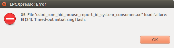

Hi Folks,
I am working on LPC1837 based development kit, I have programmed RDK with modified USB hid code where I missed the clock configuration, from then I see the following error.
Failed on chip setup: Ep(04). Cannot halt processor.
After this I am unable to flash-program or enter debug-mode,
1) Earlier to this issue, I have programmed the OTP memory bank 3, word 0 - Customer control data, Boot source selection to SPIFI, after configuring OTP region i was able to use it fine.
I tried entering the ISP mode by pulling P2_7 (user switch sw2) low and tried to program, still I see the same issue.
( I noticed D2 (yellow) & D3 (Blue) LEDs glowing), is this the right indication for ISP mode ?

Nc: Flash Driver V.2 startup failed - rc Ef(34): Timed-out initializing flash.
Pb: (100) Writing Flash ended with an error.
Ed:05: File 'usbd_rom_hid_mouse_report_id_system_consumer.axf' load failure: Ef(34): Timed-out initializing flash.
Pc: (100) Target Connection Failed
I am totally blocked, need your inputs at the earliest.

gvk51
Dear Team,
Thanks for the response, I have tried this (Regaining debug access to target MCU) already, did not help.
Note: RDK I have, is programmed to boot from SPIF by programming the OTP region.
When I enter into ISP mode two LEDs on the RDK are glowing is this the right behavior??
Please give me some more inputs to debug this issue.
