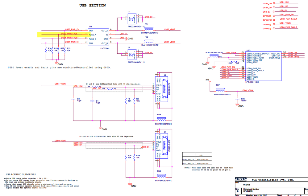

The datasheet of LPC4367 provides USB0_PWR_FAULT functionality with the description "Port power fault signal indicating overcurrent condition; this signal monitors over-current on the USB bus (external circuitry required to detect over-current condition)." What exact external circuitry is required, is there any document or application note for the external circuit?

You can use the LPC4330-Xplorer Board schematic file as reference
