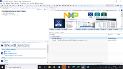

I am trying to port Threadx RTOS on LPC54608J512BD208E microcontroller. The first step of the portin process is linking the Threadx run time library tx.a with Application project.
I have followed the following process of linking external library through MCUXpresso but it didn't work.
"https://community.nxp.com/t5/LPCXpresso-IDE-FAQs/Creating-and-Linking-to-Library-Projects/m-p/469212...
I have attached source code for reference.
I am getting "-ltx library not found error".
Please help in resolving the issue.
IDE VERSION: 10.3.1_2233
Threadx source code: https://github.com/azure-rtos/threadx
Also, it would be very helpful if i can get any reference ported code for LPC546.

You said: "I have followed the following process of linking external library through MCUXpresso but it didn't work."
What problem did you encounter? Please send me your problem screenshot.
We need make sure the lib file was build under the same IDE version of you project. Are both lib and application under MCUXpresso 10.3.1_2233?

1) URL of library linking process: "https://community.nxp.com/t5/LPCXpresso-IDE-FAQs/Creating-and-Linking-to-Library-Projects/m-p/469212...
2) Error screenshot:
3) Yes, both application and library was built through MCUXpresso 10.3.1_2233.
Is there any document or process for porting Threadx RTOS for cortex M4/LPC546 controller through MCUXpresso IDE?

I have referred the same article shared by you but still it is not working.
I am sharing my code in this thread, please have a look.
The library file "tx.a" is inside the "threadx" folder in "binary" sub folder

I didn't see your lib source project.
We need to make sure the lib file and project are built under the same version IDE and with the same compiler settings.
