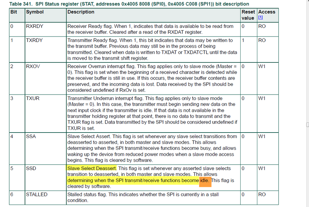

   The idle should relate to the Slave Select function, please check this description in the user manual:
  Please refer to the official code:

Wish it helps you!
Kerry
