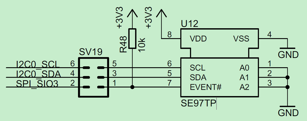

I want to make ethernet connection to my lpc43s50fet256 microprocessor .I will connect lan8710 tranciever  at24c02 eeprom .I dont know how to code my  processor pins to achieve this.
1,297 Views
Hui_Ma
Customer could refer OM13027 board schematics about how to connect LPC43xx with LAN8720 Ethernet PHY.
The AT24C02 EEPROM is using I2C bus, which also refer below circuit as an example:
The I2C bus pull up resistor value could be 10K or 4.7K as required.
Wish it helps.
