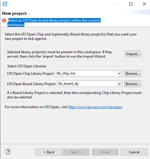

I am just starting with the NHS3152 General Starter Kit.
I have installed LPCXpresso, activated it, and added the NHS31xx plugin.
Now i am trying to start a new project:
New Project-> NHS3xxx -> LPCOpen -C Project -> Name it -> Select the target MCU NHS3152 -->
Then i get the message "Select an LPCOpen board library project within the current workspace" which stops me from proceeding. How do i solve this issue?

Hello Mario,
I figured out the issue: i didn't Import SDK!
thanks,
