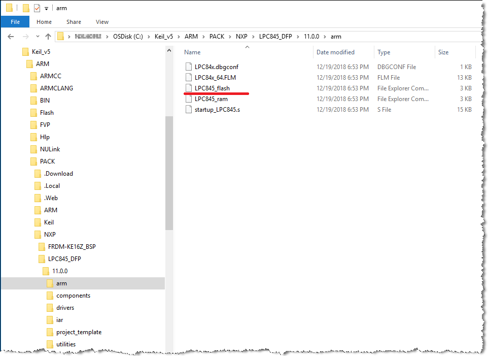

Hello Sir,
Previously LPC845 sample codes were executing correctly,
I had tested blinky code on LPCXpresso845MAX board, but
after I updated the pack installer, I'm not able to load
the file to MCU board, erase can be done but not able to load.
When checked the error in google, it directed to keil site,
where I need to download the LPC845 pack http://www.keil.com/dd2/pack/
But i'm not able to install it.
Kindly guide me how to resolve this issue.

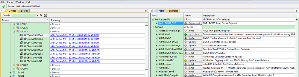

Thanks for the reply sir.
1. What's the version of the Keil you use?
I'm using Keil U vision 5.24
2. Whether you can install the pack of LPC845 in the Pack Installer.
https://community.nxp.com/servlet/JiveServlet/downloadImage/2-1119302-255964/pastedImage_1.png
IMAGE 1 ATTACHED - BUT IN TARGET UTILITIES OPTION THERE IS NO MCU PART
FOUND
IMAGE 2 ATTACHED - INSTALLED IMAGE OF LPC845
3. Whether you can share the screenshot of the download error
Please find the attached images of error when I'm loading to MCU.
BUILD COMPILE1 IMAGE - BUILD COMPILE ERROR
ERROR 1 IMAGE - CANNOT FLASH ERROR
ERROR 2 IMAGE - Error: Flash Download failed - "Cortex-M0+"
Previously it was working fine sir, when I updated pack installer again,
i'm not able
load the program to MCU.
Kindly advice.

jeremyzhou
Thanks for your reply.
According to the attachments, this issue is raised by missing the FLM file.
Whether you can check the FLM file exist in the path(~/Keil_v/ARM/PACK/NXP/LPC845_DFP/11.0.0/arm), if not, give a try reinstall the pack after removing LPC845's pack.
