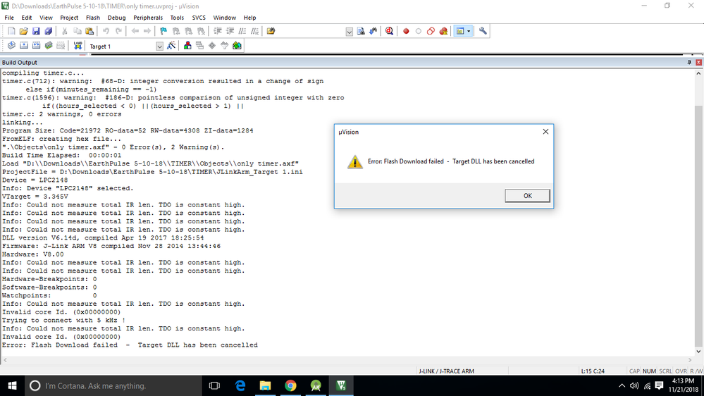

I am using Jlik to program LPC2148 in keil software. I am getting this error please help to overcome with this issue.
Thanks and regards,

Have you been able to connect with the target at least once? You should verify the following:
  1. Target processor is properly powered.
  2. Debug connector from J-Link to target processor is properly mapped, oriented and connected.
  3. The PC have installed the drivers for J-Link debugger.
  4. Keil project configuration is properly set for the desired memory, included the related Flash driver file.
Hope this will be useful for you.
Best regards!
