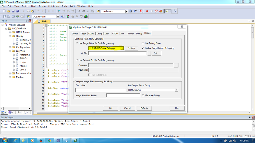

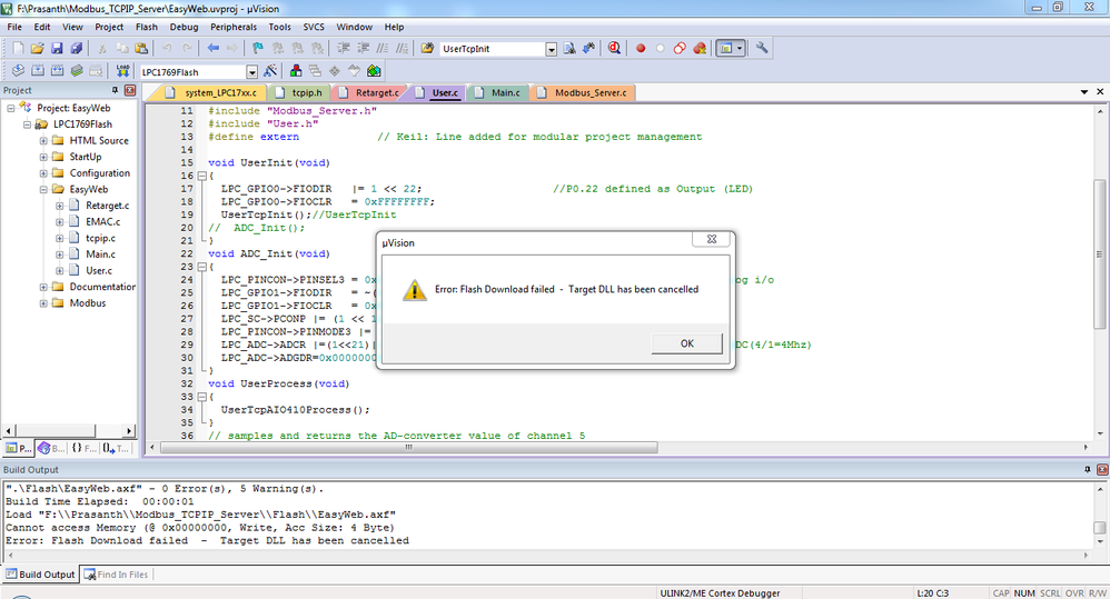

   I'm using lpc1768 controller for my application. While edit and download the source code to controller i got an error "unable to enter debug mode","Flash Download failed  -  Target DLL has been cancelled". After getting this error i can't download or erase flash memory. I search about this error to some sites and someone gives the suggestion of modify flash tools->debug settings. I tried that but no use. I attached a screenshot to it. I expect someone gives the solution. Thanks in advance.

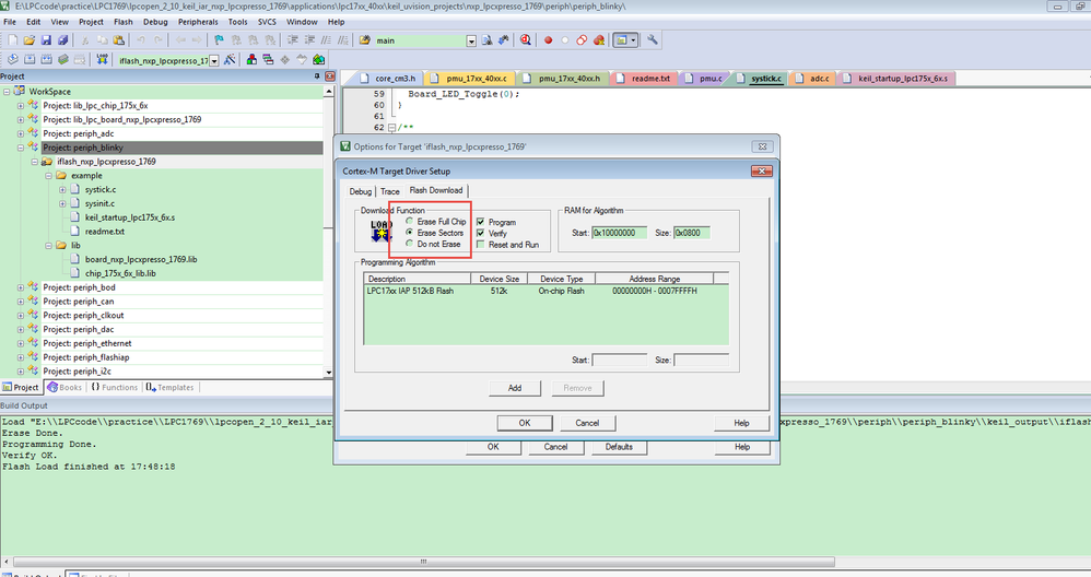

5)  In Settings in Configure Flash Menu Command - make sure  a valid flash programming algorithm is selected.
6) For LPC1768, try selecting RESET as shown instead of Autodetect as shown in one of the screens above.pastedImage_4.png
 7)  You can also try and select Verify Code Download and unselect Download to Flash: This an 6) are default for the LPC1768 Keil MCB1700 board.

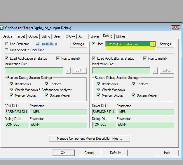

kerryzhou
Hello prasanth R,

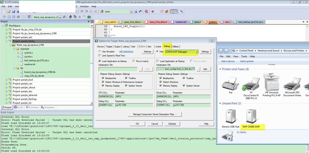

   From your picture, we can find that your MDK project is using the ULINK debugger in default.
   Please check your debugger, what the debug you are using?

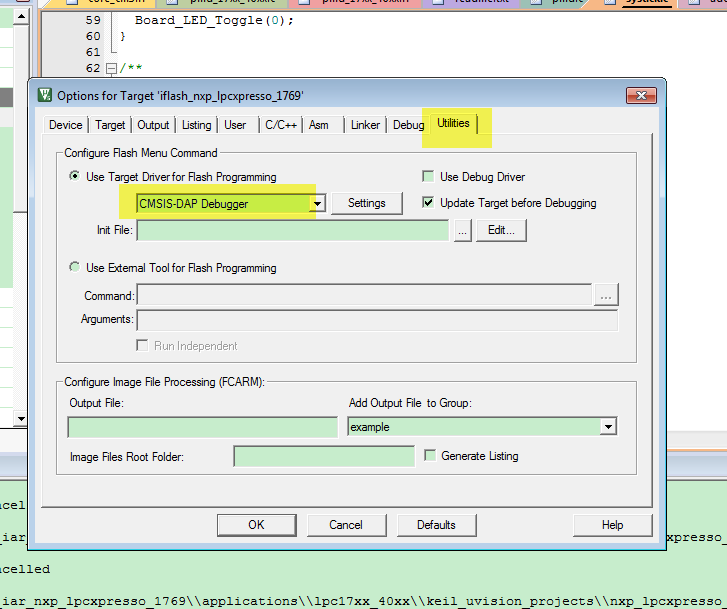

   Now, take my LPCXpresso LPC1769 board as an example, my on board debugger is:CMSIS DAP.
   So, I need to modify the options debug to CMSIS-DAP debugger.
So, just modify the options debugger, and utilities debugger to your real debugger interface.
Wish it helps you!
Kerry

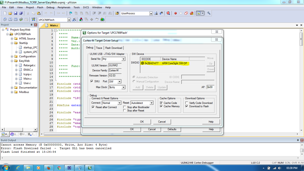

prasanthapplied
Dear Kerry Zhou,
                   Thank you very much for your response. I'm using ULINK2 debugger for my project. It gets recovered by computer hardware tools. I attached a screenshot to it.
   Debug and Utilities settings has a right debugger selection
   I thought debugger selection is not a problem. Because i can read SW device IDCODE. 4..PNG

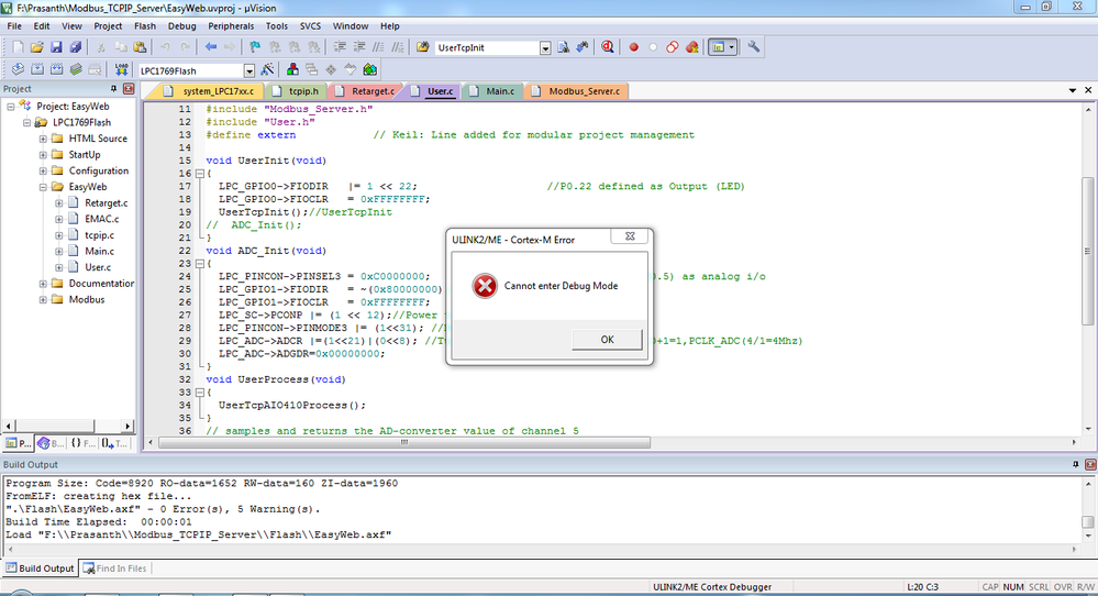

         I tried lots of times to download a program. I getting an error of "cannot access memory" or "cannot enter debug mode". I don't have an idea to solve it. Please suggest some other solutions to solve this problem.

   Please try to modify the debugger to CMSIS-DAP

prasanthapplied
Dear Kerry Zhou,
             Thanks again for your reply. I'm sure debugger selection is not a problem. I tried lpc open examples "easyweb"  Ethernet application to my board.
             Now my board getting work itself. While problem occurred i tried to erase my controller flash frequently using "keil IDE","mcu expressoIDE" and "flash magic" but there is no use. After some 3 days surprisingly it get erased by "MCU Expresso IDE". After that erase my board gets works fine. It gets programmed by keil IDE.
