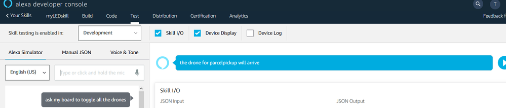

It is possible to test the LED's on the hardware using the alexa simulator on alexa developer console without using the alexa echo dot device right?

That is correct, you can type in the command in the Alexa Simulator and you can test it without the echo dot.

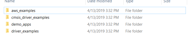

If I am trying to do run the "LPC54018iotmodule_aws_remote_control_wifi" example, How should I import the whole project folder into MCU Xpresso?
I can find this particular application under AWS examples but not understanding how to pull the project folder into MCU Xpresso.

In order to import an SDK example, I recommend that you take a look at chapter 7 of the MCUXpresso IDE User Guide.
Once you have the project you can see that the project is essentially the same as the previous one, with added peripherals. To update the endpoint API, Thing name, WIFI SSID and Password you can find it in the same file as your other project "aws_clientcredential.h"
I recommend that you use the step by step instructions you used in the led control project as a reference. You will notice that everything else is the same, and the principal changes occur in the main.c and remote_control.c.

It is located in th SDK examples for the LPC54018iotmodule and you will find it under the tab for AWS_examples.
