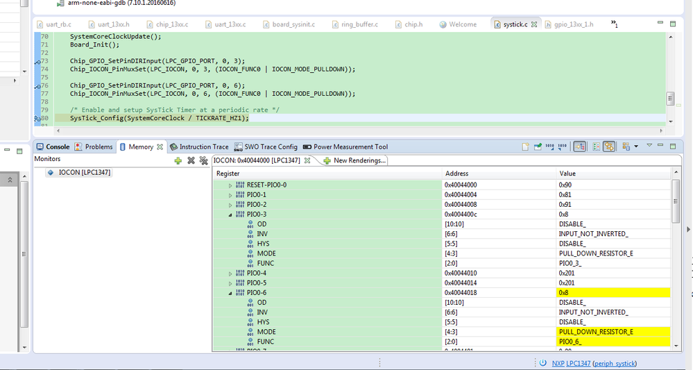

I'm a newbie and trying to enable the pull-down resistor on LPCXpresso-LPC1347, but it doesn't works in different cases...
This case works:
Chip_GPIO_SetPinDIRInput(LPC_GPIO_PORT, 0, 3); Chip_IOCON_PinMuxSet(LPC_IOCON, 0, 3, (IOCON_FUNC0 | IOCON_MODE_PULLDOWN));
but on port 0 pin 6 it doesn't...
Chip_GPIO_SetPinDIRInput(LPC_GPIO_PORT, 0, 6); Chip_IOCON_PinMuxSet(LPC_IOCON, 0, 6, (IOCON_FUNC0 | IOCON_MODE_PULLDOWN));
I've tried turn on IOCON and GPIO clocks but the effect is still the same (LPCOPEN surely turns it on by default). What I am not doing right?

    After debug it, your code works, you can check the register:

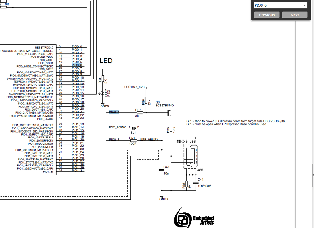

   You said it is not working, I think it caused by the external hardware circuit:
If you are not believe it, you can remove the R57, then test it again.

So in fact I cannot use PIO06 as an input with pulldown because of the R57. My question is why the official user manual for this board tells that I can?... Is there a clear answer?

   This pin already used for USB pin in the hardware.
   Actually, you still can use PIO6, just like what I have said, try to remove R57, then try again.
